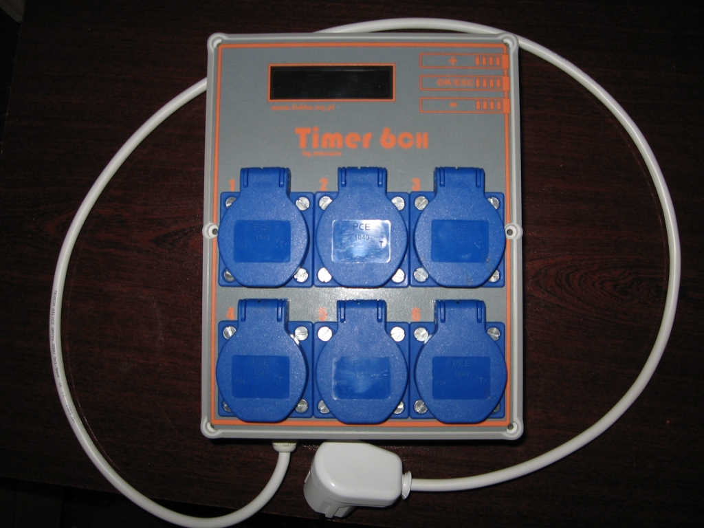

6-channel timer of own construction
This 6-channel timer can control (enable) connected to it devices at a certain, fixed time. Executive elements are triacs BT136 control from optotriacs MOC3041. Settings are stored in EEPROM and the clock is maintained by capacitor 1F. All the necessary materials are attached to the original thread – link below.
