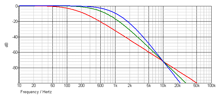

Yes, but I don't know where you got 2268 from.
Maybe it's worth using a higher order filter?
For 2'nd order, Fc ? 165 Hz
For 3'rd order, Fc ? 650Hz
For 4'th order, Fc ? 1300 Hz
The pictures below compare the frequency response of the 2'nd, 3'rd and 4'th order filters. 3'rd order looks like a worthwhile improvement to me, but I don't know your requirements.

For a 3'rd order filter, you'd have a smaller input impedance and/or a bigger output impedance, so that's also a factor. Another option is to have less than 10 to 1 ratio between the values.
