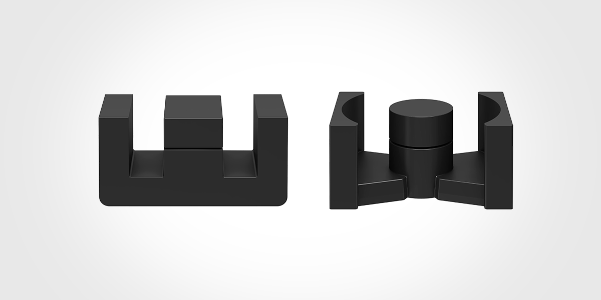

The following claims to be an ETD59 core with AL=250.
....Does this mean that one of these halves, coupled with a totally ungapped half, gives an AL of 250?
(or do you need two of these gapped ones together?)
The accompanying datasheet doesnt say
....With "normal gapped" cores, the other half is not gapped...but these are brand new "distributed gap" cores, and nothing is said about how you get the AL=250
The following video...
...makes it appear that two "distributed gap" cores are needed to be mated together...if so, then that is a deviation to the older non distributed gap cores...where the "other half" was always ungapped.

The distributed gap design doesn't make much sense if it's paired with an ungapped core, isn't it? If you don't believe, you can also calculate required gap width for the Al values.
Thanks, yes i think the confusion arises because they have "stolen" the term "distributed gap".......AYK, what they have done is not a "distributed gap"....that is something looks like an ungapped core but is made up of a mix which is literally incorporating the gap all evenly amongst it in a single homogenous mixture....but what TDK have done, is more like a "spread-gapped core"...which kind of makes you wonder if the AL values they quote do indeed belong to the "ungapped" and "distributed gapped" halves....they could do after all, and it would still be a "more distributed gap" core than the old variety.

Beyond sophistic hair-splitting, if a manufacturer of magnetic components advertizes "distributed gap" ferrite core, I expect something similar to the TDK core.
the distributed gap cores mentioned in the links above are a response to requests for such constructions in an effort to reduce " gap loss " where the windings are close to larger gaps ( usually only in the centre ).
