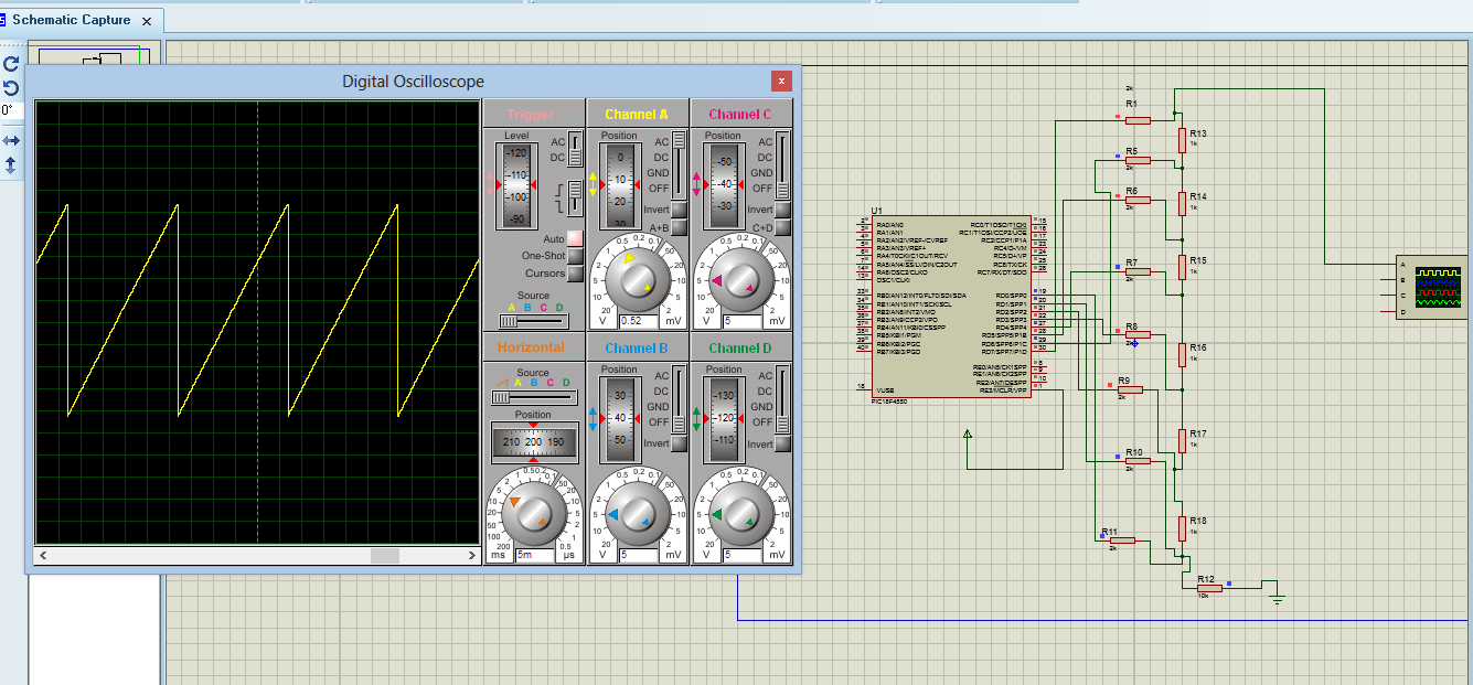

How can I generate A sawtooth waveform using PIC18f4550, is there a way to do so??
Feed PWM with a counter++. Connect an RC filter at output.
Or you can use an R2R ladder DAC on any of the 8bit port (PORTx) and write counter++ to the PORTx.
The problem was solved by making an R2R ladder !! Image attached !!
