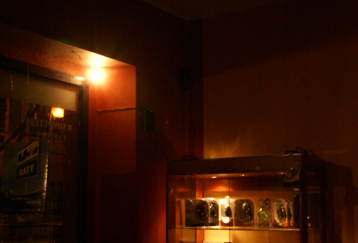

Additional light:
USB cameras are connected to the server, on which Slackware (Linux) is installed. A script was written in PHP/HTML/CSS, which sends control signals through the RS232 bus to the executive board, to which relays controlling the operation of individual sections of the lighting are connected.

Below there are some screenshots of the interface. The first one shows additional lighting turned off (view from the camera), the second one - turned on. Dynamic graphics present the relays state. When the relay is turned on, a lamp lights on the web page. Also hours of automatic on/off those sections – so that on Sunday bulbs do not light unnecessarily. The appearance of the interface corresponds to the physical location of the controlled section.
