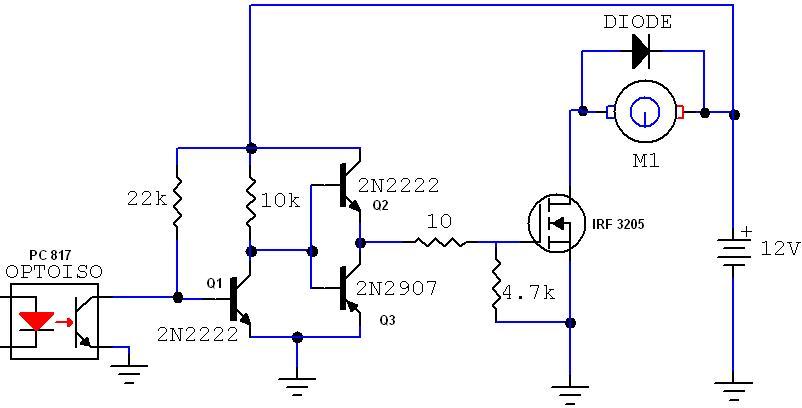

PWM and MOSFET problem ?
I understand you are using n-channel MOSFET. In original schematics gate voltage range is ~11V - 12V dependng from optocoupler. However Vgs(th) of the FET is +3V. Therefore the MOSFET's working point located in saturation area every time. From my opinion you'd better to use p-channel MOSFET instead or change gate voltage range. In next revision of the circuit you are using PNP and NPN pair to manage MOSFET gate voltage. This additional circuit capable switch MOSFET on/off and as result solve the problem.

About diode I agree you have to use fast diode to depress positive spike and preserve MOSFET from damage
Added after 1 minutes:
It's not enough technological diode inside MOSFET
That's good. It's a switch, so saturation is highly desirable.
do i need a diode in reverse biase across motor to kill inductive kicks?? as MOSFET has builtin Diode
Sure you need. Look sharp! MOSFET reverse diode is conducing with negative drain voltage while the freewheeling diode conducts with positive drain voltage above supply, simply opposite.

So you mean, that the MOSFET doesn't turn off in the orginal circuit? I think, it turns off, but too slowly. This isn't particularly a problem of threshold voltage rather than a too high driver impedance.
But diode function is protect MOSFET during fast changes current through inductance.
The diode also protects the MOSFET. But that's not it's primary function. The primary function is to allow the stored energy in armature inductance to drive the motor. The circuit looks like an usual protection circuit, but in PWM operation, it has a different purpose. The MOSFET is already protected by it's built-in zener diode. By utilizing this protection method, the stored energy is generating losses at the transistor instead of driving the motor.
However Vgs doesn't drop less than ~11V. It's not clear how it off at all.

Hameeds01....Are you sure your driver circuit provided here is working?. I doubt the 2N3907, a PNP, can be turned ON in this configuration.
Where did you get this idea? When the octocoupler isn't driven, it falls to 0.
You right, emitter and collector are mixed up. The push-pull circuit from the quoted thread is showing it correct. There are many ways to confuse even a simple circuit.

After adding the diode across the motor terminals now the motor is running very smooth, quiet & no whistling sound, now it is making good use of the stored energy in the Armature of the motor during the Off time.
At the moment I m using ordinary 1A Diode tomorrow I will change it with 10A (FEP16CT) high speed diode soon.
The Push-Pull driver is working absolutely fine, no more heating problem even @ the load of 25A.(tested)
@ stanislavb
When the Q2 2N2222 (NPN) is in a forward biased condition the Vgs = 12v
& When the Q3 2N2907 (PNP) is in a forward biased condition the Vgs = 0v
at a time only one can be in a forward biased condition, when the opto coupler is in ON state only Q2 will conduct , & when the opto coupler is in OFF state Q1 & Q3 both will conduct….
Hameed u can also shorten your circuit...Use a power mosfet driver instead of transistors...u can use series gate resistor of 10ohm to protect mosfet from HF ringing..

Try using a 555 as your PWM, alos I think you should configure your opto-coupler and the transistor in a darlington way, because the saturation voltage of the opto may be to high so the 2n2222 would not turn-off completly. I like to start over in a different way when it is not working!

I would use an optocoupler like the hcpl2201 with a bipolar push-pull stage after it to deliver enough current to turn the mosfet on and off quickly enough.
Your problem there is a very slow turn off time.
