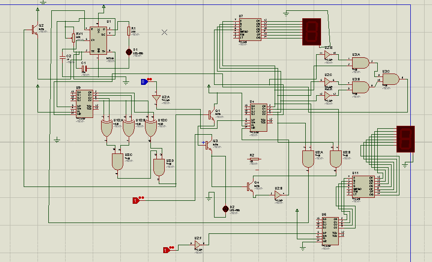

my problem is the 74ls 192 does not count up i try it in proteus and it works but when i implemented it in breadboard it doesn't work
---------- Post added at 11:25 ---------- Previous post was at 11:24 ----------
and the display is not stable also
this is my design
---------- Post added at 04:22 ---------- Previous post was at 04:19 ----------
this is my design
can't see the image clearly. it might be a connection problem. double check your circuit wiring, power and ground connections.
@blush
First of all, what is the purpose of this circuit? :-D Some parts are just standalone, those are not connected to the circuit.
- There is not a good idea to mix bipolar transistors and logical gates in the way you have.
- Need to connect some limiting resistors (100ohms) in between BCD decoder and 7 LEDs segment display
- Connect some pull-up resistors (10k ) from the not used ‘Count Up’ and ‘Count Down’ inputs to 5V power supply

the logic switch there represents a sensor.. what should i do with the transistor connection?
---------- Post added at 17:05 ---------- Previous post was at 17:02 ----------
i am making a conveyor using logic gates only.. the led represents the motor and it is a conveyor that is controlled by a sensor
In order to help you we need to have more details about functionality of the above circuit.
Can you provide state table/state diagram for it?
thnx to u mister_rf ur comment helps me a lot i solve this problem
