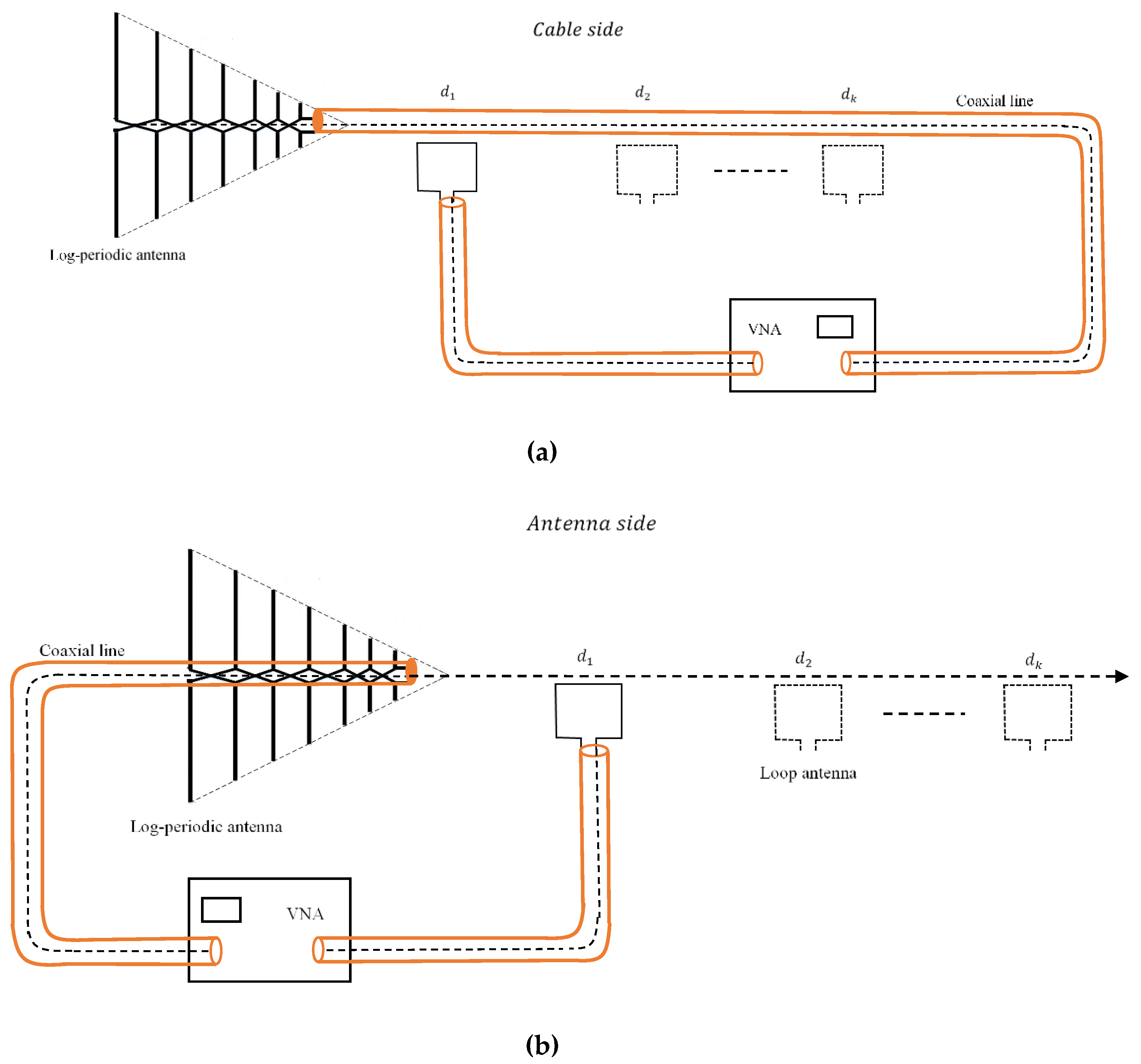

I don't say that is not a good idea to use a balun in a Log Periodic antenna, but most of the log periodic antennas I've seen do not use a balun, and connect the coax cable directly to the antenna.
I might understand stuff wrongly, or incompletely, I'm really a RF newbie (I have a ton know-how/experience in all kinds of software tech).
_Connecting_ a coax to a dipole is of course possible, but
- it will use the coax cable to transport a balanced signal (for which it is not designed)
- it will make the coax shield part of one arm of the dipole array
- not using a balun to make the balanced dipole array output into an unbalanced signal before sending it down any wire .. seems like a bad idea?
- if the coax shield has any connection to GND downstream (eg LNA etc board), it will make all the downstream GND part of _one_ of the two dipole arms
as said, I might be pretty wrong, not sure.
if you have an argument of _why_ the use of a coax in such a way might be a working solution for dipoles or dipole array or any balanced antenna, I would be highly interested!!
I do want to learn;)
