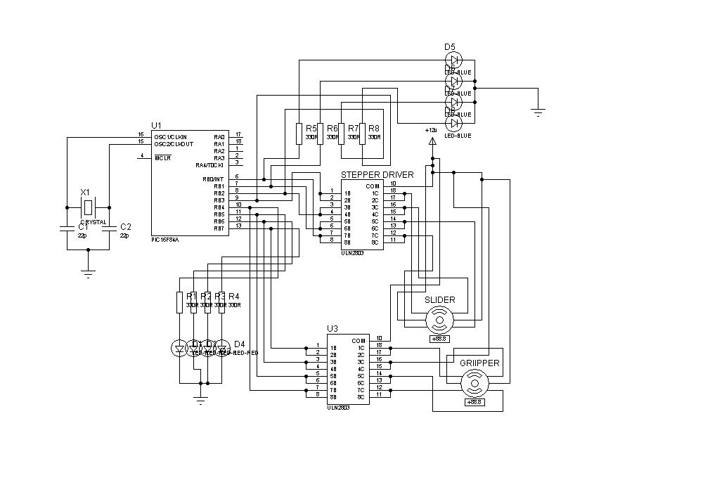

please help me with my problem about mcu

whats wrong with my project...i created 5v regulator supply connected to pic16f84a and then if i connect it to pic16f84a, the voltage regulator produce heat as well as the mcu..and if i disconnect the regulator from mcu...the regulator doesnt release heat...it is possible that my mcu has defect?

thanks to all..but i checked already the vss and vdd if they are shorted...they are not shorted...i check again the temperature of mcu and still hot...

please check this circuit and code if it is correct
check this image of my circuit:

Topic changed. Let us discuss on the first problem. Please tell us wheather you are feeding the power from battery or transformer. If it is through thransformer please confirm that your using a bridge to rectify the voltage. If all above yes then please check your 5V regulator it is faulty, provided that your poliraty is correct.
Thankyou
thank you..i use an multi purpose adapter..it is ok to use this kind of supply to connect to the voltage regulator circuit?
PLEASE REMEMBER THAT MULTI PURPOSE ADAPTERS DELIVER MORE VOLTAGE THAN REQUIRED. IF YOU SELECT 5v IT WILL DELIVER NEARLY 7V THIS IS WHY YOUR MCU IS HEATING.
Please change the voltage to something like 3 or 4.5v and measure the output voltage it should be <= 5V for MCU.

i already check the output voltage of the voltage regulator circuit..it give 5.01v but still the mcu is heating...i dont know why.
Use of bridge or use of 220uF 16V capacitor for input side and 10uF 16V is required in your case.

thank you very much..i used 470uf in the input side and 4.7uf in the output side...i will try 220uf and 10uf
I am 100% sure of only 2 problems.
1. Your adapter polarity is having some problem.
2. your regulator is having problem.
Alternate best fail-safe solution is use 4 1.5V AA battery without 7805 and power it to MCU. If this works then you MCU is safe and above are the only problems. But I would like to see some kind of diagram of your actaul setup other than what you showed above.

i have here 6 battery which is equivalent to 6v...
if the mcu is still heating..it is possible that the mcu is already damage?
Don't use 6V the MCU requires only 5v so use only 3 to make 4.5V. If still heats then it is MCU problem. The heat should be more than room temperature to conclude the MCU problem. I am sure the mcu cannot go bad unless you have given more than 5V to MCU.

remove all the ICs from the board and see the VCC in the 40 Pin IC base for controller...
then put the controller without any other ICs and check the VCC and see if it gets heated.. if still it gets heated then IC is gone... if not insert other ICs one by one and find out when it gets heated , and find the fault....

We really don't know how his setup is. Hence I requested him to put his setup so that we can solve the problem in just one post.

i can i post the setup?the circuit design only or i will take picture of my actual design?
Either schematic drawing or picture any thing will do as long as it is clear.
