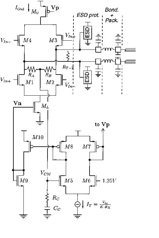

I'm designing an LVDS but I've problems with millers compensation. How can I know the value of Cc and Rc in my system? How can I calculate the poles/zeros of the system.
Depends essentially on your output load. Estimate (by experience, if available), simulate, optimize.
marxelus said:
... the poles/zeros of the system.
By simulation.
You can simulate it in the loop to see the phase and gain. add cap and inductor.
