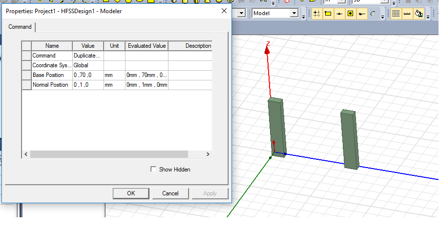

My problem is i am not getting how to give the position values.
After using that duplicate option 1st we should select base position right? i have chosen that as the FSR end point position later we have to give the values for dx dy and dz right for that what values i should give??
i am giving the position values for that but it is not exactly 90degree, it is slightly changed i am not getting where i have done wrong
Have a look at the figure I think it should solve your issue.
Be sure that your base position and normal position have same non zero components as you are using mirror command which will keep sure the normality issue
Thank you:) can you tell me why the position changed from 70 to 1 on what basis you have made that??
for square shape i am asking can you set the plates adjacently and send an image it will be helpful for me. plz
Command DuplicateMirror
"Coordinate System" Global
"Base Position" "-46.5 ,49 ,0" mm "-46.5mm , 49mm , 0mm"
"Normal Position" "46.5 ,49 ,0" mm "46.5mm , 49mm , 0mm"
i am getting the image like this
I am not sure if I got your problem correctly have a look.

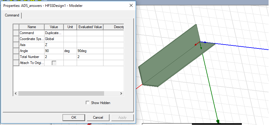

I use the following command instead of mirror
Edit>Duplicate>Around Axis
As in this case you do not need mirror command
Can you tell me what values you have given for dx dy and dz for this around axis option.Here also we should give values na??
hai nomigoraya thank you so much i got that one...Thank you for your precious time
