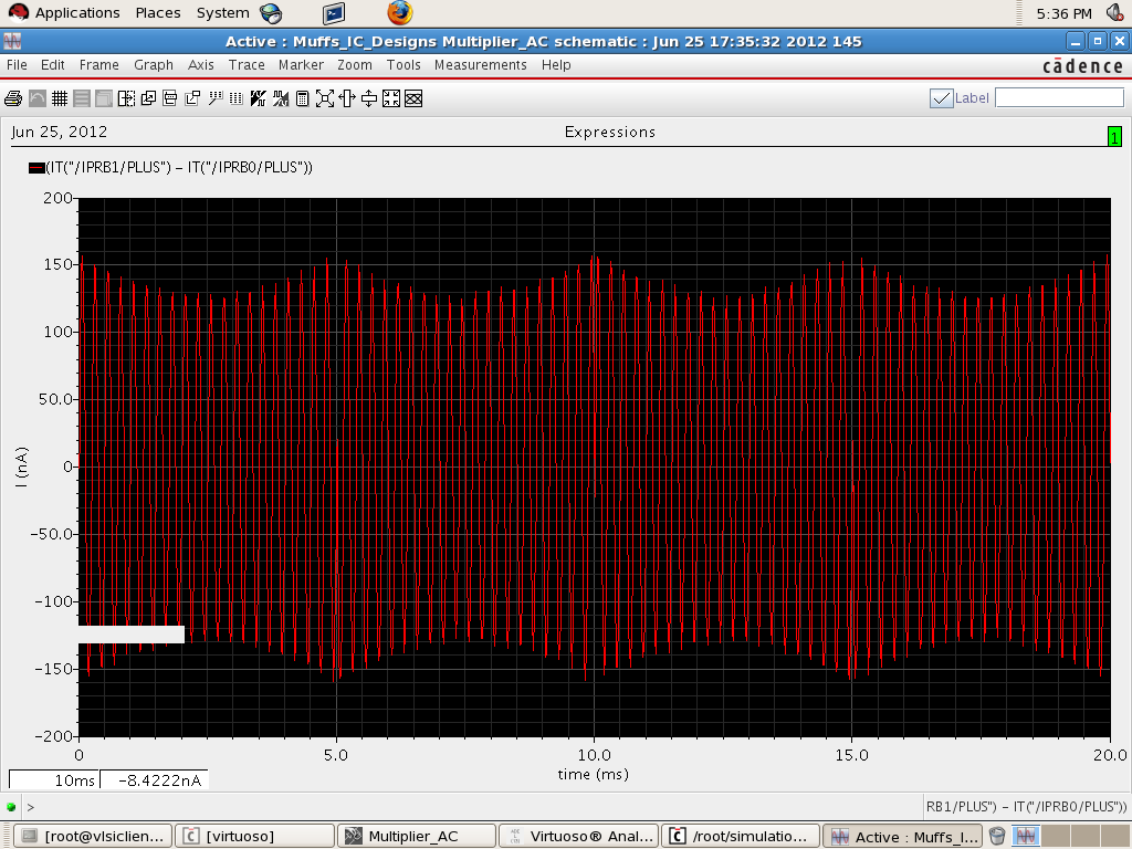

Th output tht i am getting should be modulated wave for these two frequencies..But it is as shown below.

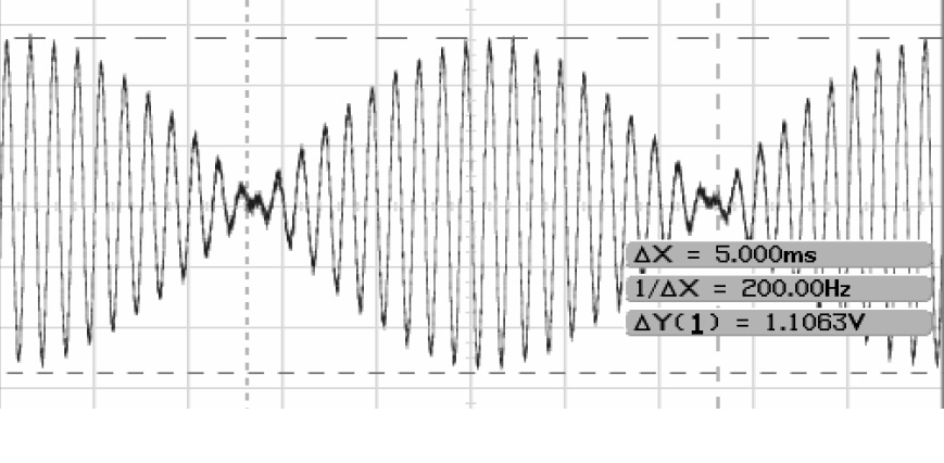

What i expect is

Hi muffassir,
I imagine what you got is the correct result for a function like y = sin ωt * 4sin 40ωt
What i expect is
If you need a full-through modulation, the modulation (low-frequency) signal must be considerably stronger, see here: View attachment sin-gen.pdf
