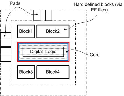

I'm using SOC Encounter as a layout tool. I need the florplan depicted below:
The problem is the tool uses hard blocks sizes while calculating CORE size. So the question is how to exclude them from CORE size calculation (it should be determined only by Digital_Logic module).
The hard blocks are represented in LEF files.

I don't need to place the hard blocks (macroses) on CORE's rows (where only std cells of Digital_Logic part should be placed). So I want to exclude the macroses sizes from CORE (row array) size calculation.
Digital_Logic and macroses has different power suppliers.

I'm trying to represent my needs through the picture below :)
So now I can't make CORE size smaller than the sum of the blocks sizes and Digital_Logic size... But I need to place on rows ONLY Digital_Logic...
The core is the same between the two floorplans you indicates.
Why you don't connect the macro with encounter instead using Virtuoso LE?
if I have a macro which include some pads, this macro will cover the pad row and the core area.
