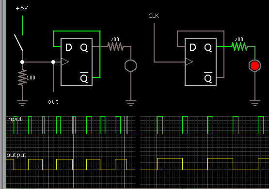

A toggle flip flop can be thought of as a divide-by-2. (Push-on, push-off.)
The D flip flop is easily transformed into a divide-by-2.
OK, I used to know more on digital designs, but I have been out of touch for many years now. So, could you explain to me how to build a T FF from a D FF and an inverter in a more detailed way?
At left is the toggle FF. At right is the divide-by-2 FF. They act the same way.
The inverting gate does not seem necessary, although it can be used to make the output transition at the trailing edge instead of the leading edge. Anyway there's the chance I didn't grasp the particular concept which the author had in mind.

He used the above D FF and inverter to build an T FF, and then to build a 4-bit ripple carry counter from those T FF whose schematic diagram is shown below. How does this counter work? I know it's supposed to count the clock pulses, but how is that, technically speaking? I assume the initial state of the encounter is 0, that is q0=q1=q2=q3=0. Explaining the next two lines in the truth table will do for me to understanding how it works. Any help will be appreciated.
Your left schematic diagram is the same as the one I attached. But how that D flip flop and inverter is the same as a T flip flop?
The D ff contains many logic gates. When we turn a D ff into a toggle ff, the D ff is reduced to a simpler function than it normally is capable of. Which is to say, a toggle ff could be built as a simpler device (probably halfway between an RS ff and a D ff). However as we have it today it is convenient to reach for a D ff and add a gate or two, when we want to create the toggle function. It is convenient that we have the D ff ready-made in a package. As a result it becomes familiar to our mind. In the same fashion tutorials reach for the D ff, in order to illustrate the toggle function, as well as the divide-by-2, as well as binary counting.
Thanks, but what I was trying to say is that how a D FF with an inverter (or the inverted output) become a T FF. Your schematic (and the one I attached) doesn't give the toggling effect that T FF gives. As I understand it, the schematic diagram gives the following characteristic table
Qn  Qn' = D  Qn+1
0     1        1
1     0        0
Which one is the T input? Is it Qn'? If yes, when D=0 the output isn't held, it's toggled!!
That is because it is not a T flip-flop it is a divide by two a.k.a a T flip-flop with the T enabled all the time.
