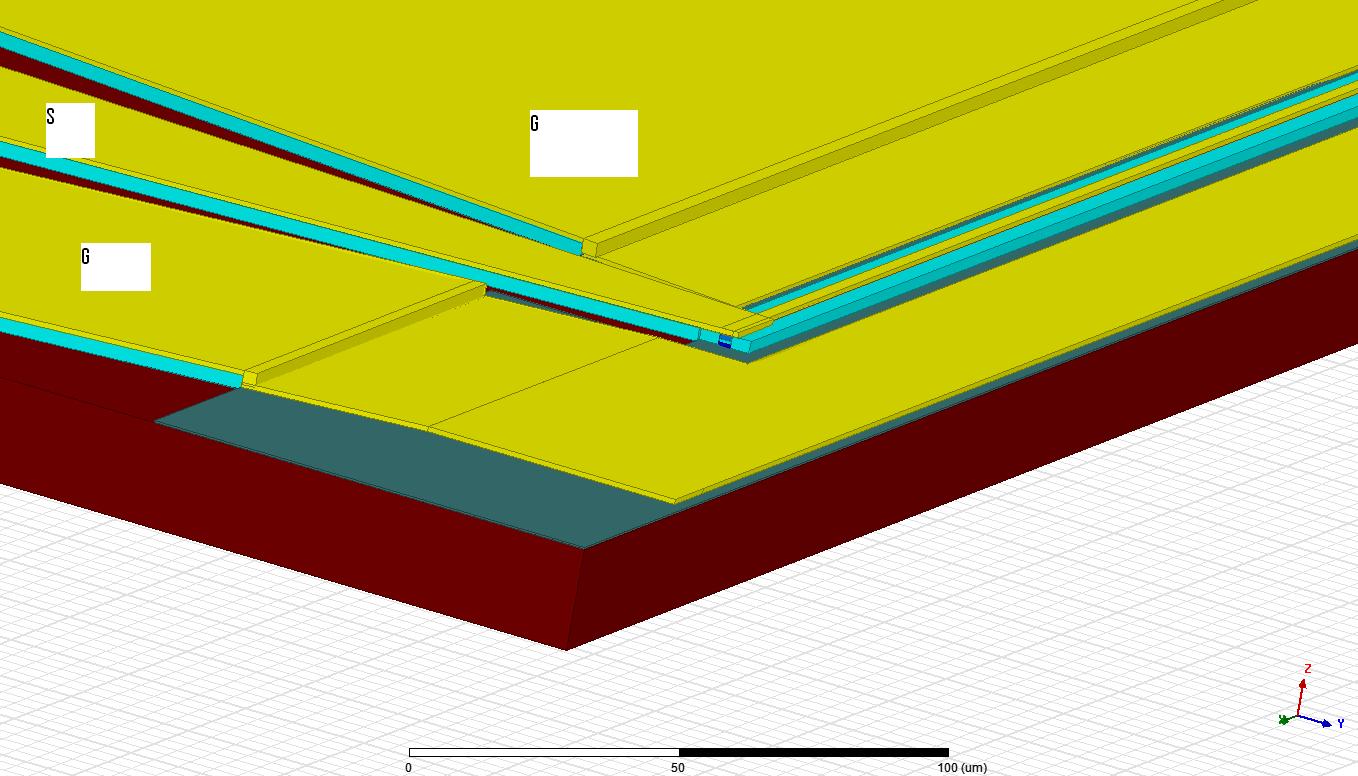

Actually I need a CPW-CPW transition. I am attaching an image file which shows the transition. It starts with CPW which is tapered to CPW again. The GSG tapper is sitting on to substrate directly then the middle section metal is sitting on layer of semiconductors. Then the output CPW is again another tapper.

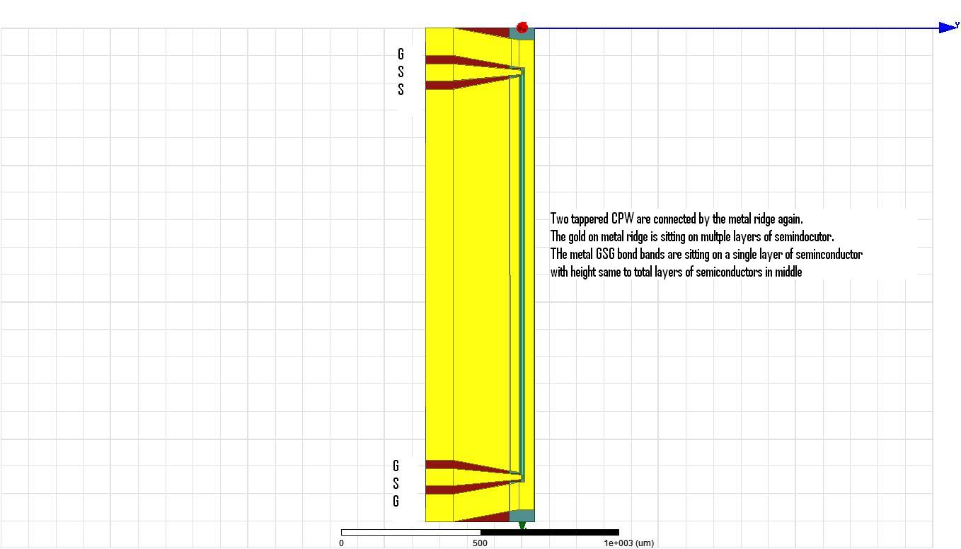

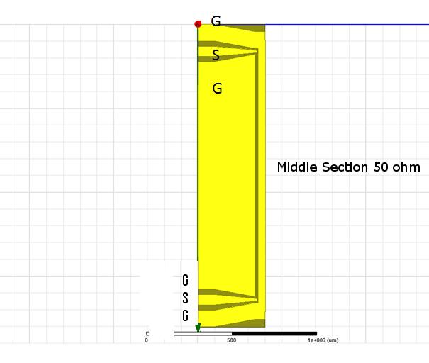

Johnjoe this is the top and side view of device I am designing. Now my question is the middle section impedance should be close to 50 0hm. I am not sure that how can I design tapered CPW bond pads close to 50 ohm so that there are no mismatch reflections.

sorry for the late reply. Assuming that both connected cpws have 50 Ohm, just keep the taper as short as possible because it is quite hard to analyse the taper analytically. For which frequency?

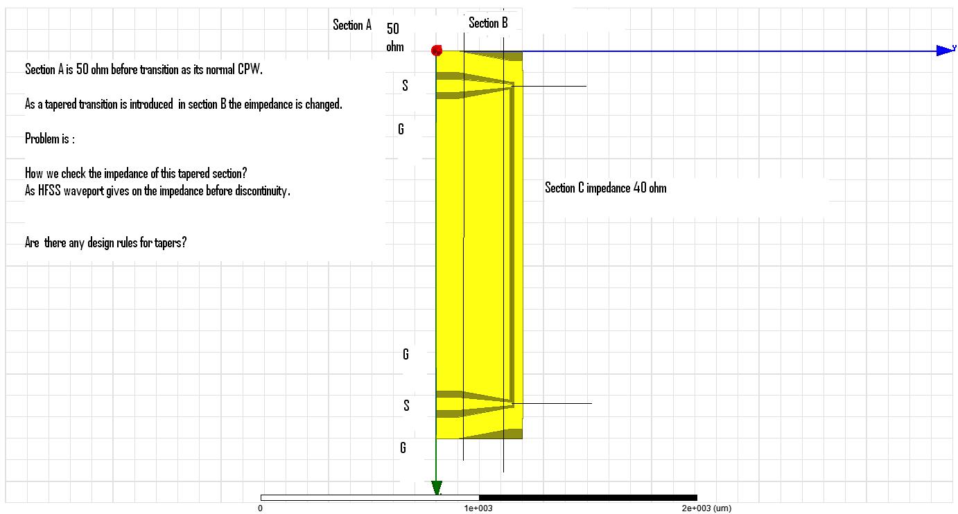

Hi John thanks for the answer but my confusion is still there . I am again attaching the picture it explains what I am asking
<a title="help CPW.JPG" href="http://obrazki.elektroda.pl/4733060900_1382436448.jpg"><img src="http://obrazki.elektroda.pl/4733060900_1382436448_thumb.jpg" alt="help CPW.JPG" /></a>
Ok, you use your taper for impedance transformation 50Ohm->40Ohm? Simply simulate just the taper with port impedance 50 Ohm on one side and 40 Ohm at the other side.There is no analytic form.
