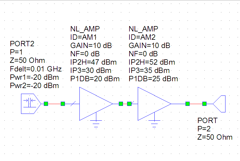

I calculated the total 0IP3 of two amplifier block.
1st block has G1(power gain)=10dB and OIP3-1(output intercept point)=30dBm.
2nd block has G2(power gain)=6db and OIP2-2=35dBm
using derivation 1/OIP3=(1/OIP3-1*G2) + (1/OIP3-2) I calculated over 0IP3.
After i simulated it in AWR 2004 and take not accurate results . And i dont understand why OIPN is depend on input power of the fundamental component in ?
for example, at Pin=-30dBm AWR show OIP3=30.605 dBm
at Pin=-10Bdm AwR show OIP3=16.7 dBm
P1db=10dbm for two amplifiers.
:?: why it occurs? What desing environment I should use to verify any calculating concerned with intermodulation distortion?

1. OIP3 should be measured well below the (at least 30 dbm or more below) the OIP3.
In your case you have measured with Pin = -10 dBm, Pout = +6 dBm, so it is
much too close to the P1dB and OIP3.
Try it with Pin= -40 dBm, and it should be approx the same as in the case of Pin=-30 dBm
2. Are you sure that P1dB and OIP3 are about 20 dB apart ? Usually it is about 10 dB.

I have such amplifier. I calculated overal OIP3 about 35dbm, but AWR give me 33.57dBm. I dont't understand why result is different? Can i trust AWR or derivation of total OPI3? or maybe i'm mistaking
Added after 7 minutes:
Sorry, amplifier is invisible
If I read it right, in your AWR simulation, you used 10dB gain for the second stage, not 6dB. If the correct gain is used, you should see calculation and simulation in good agreement.
20dB difference between P1dB and OIP3 is normal for amplifers of high linearity .
