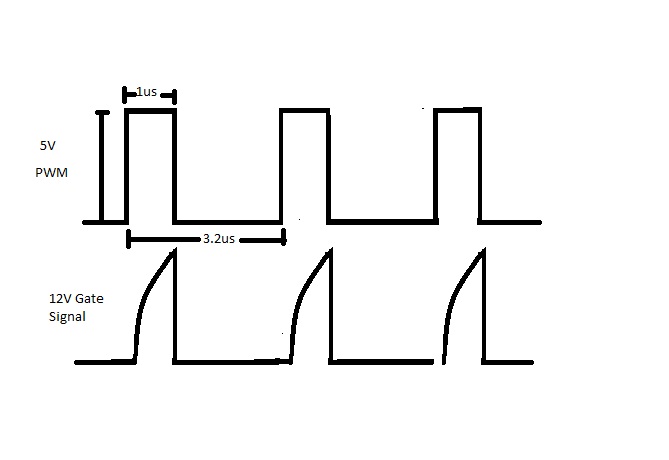

I am adding pwm signals for the gates of igbt.currently i am using 30v for dc bus for checking purpose only becoz my load is short ckted.
I don't see obvious circuit errors. Using slow 1N4007 as bootstrap diode might cause inconvenient current peaks, I would use a fast recovery diode.
But more likely the problem is brought up by details that can't be seen in the schematic, e.g. control waveforms, circuit layout, DC bus bypassing.

I have change RG=21ohms and i put 1K resistor between gate and source.I also replace IGBTs withe mosfets but still my borad is short circuit after 4-5 seconds.Also my gate signal become distorted too.
re: Help with H bridge not working?
Looks like normal operation with medium gate resistors and large MOSFET input capacitance.

"Normal operation" in my previous post primarly means that the waveform are expectable under specific conditions, not that they are good this way. Gate voltage rise time is a design parameter, if you want faster rise time (apparently you do), you should determine what is making it slow (I guess gate resistor and MOSFET input capacitance, possibly too large bootstrap capacitor ESR) and modify the circuit.
