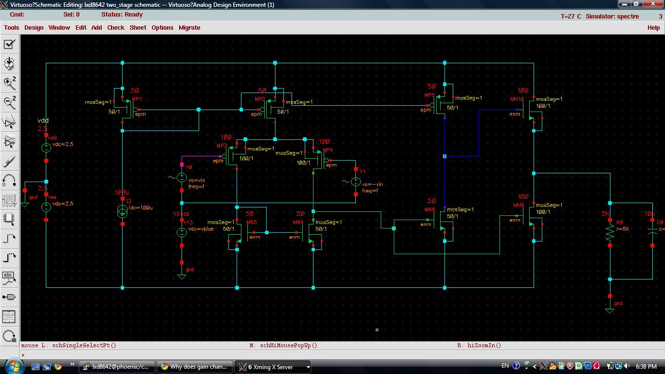

Hi, I was just trying to find the gain of a differential stage using cadence. It's a two stage op amp, with the first stage of single-ended differential and second stage of common source. While I fix the other parameters and configuration and change the signal voltage input of the differential stage from 10mV to 1mV, the gain is changed from about 40 to 80. Can somebody tell me why? Thanks!

Maybe 10mV is enough to more than steer the front end
and you are compressing. 80dB gain (10000) means 10mV
would become 100V and you are not (I expect) designing
an op amp with that kind of supply or output swing.
Hi guys, thanks for the reply. I really appreciate it! Yes, I think I need to use 10uv for signal input instead of 10m and it comes to be OK after I change that. Sorry for not explaining things clearly, for I'm still pretty new to this domain.

I'm having some other issues here. How do you adjust Vds? Like in the second stage, common source stage, if I want to decrease the drain voltage, what should I do? When I did the simulation, that drain voltage is too high, making the transistor in the output stage in triode region.
I'm using a 0.5um technology, and select the channel length in the schematic to be 1um. How should I choose the typical value for the width?
In the first differential stage, it seems when I change the biasing voltage, the Vdsat of that input transistor will change as well. In this case, how can I calculate the input range?
The schematic is as below:

since you are new to analog design, grab an analog text book and find out how to design opamp step by step. you will get an approximate transistor size after doing some rough caculation according to the specifications your required. and then do optimization by simulation.
when the width of the MOSFET is large you should do it multi-finger style in layout, here in your symbol denotes "mosSeg" i think.

Hello ray.deng,
The question "how to adjust Vds" is very general...Do you have a spec for output common mode voltage?If yes,you will try to set the output dc potential at that point.If not,try to fix the output CM voltage at the point (Vdd+Vss)/2 (0 Volt for your case,as i see from the rails of the schematic capture you posted).Now,suppose that you have decided the output dc potential.How to fix it?Ok,you can play with all other parameters (W,L,Vgs) of the common source stage and manage to satisfy your specs when you have the out CM voltage fixed in parallel at a desired point.You can use ideal dc voltages sources and set the dc voltage of the ouput node and then size the transistors according to your needs.You can refer to several analog design books,as other people suggested above,that offer some design techniques.
Your specs will define the answer.You will decide the L at each transistor depending on the inversion factor you want,the parasitics at a specific node,matching etc...An initial rule of thumb is to use about 2-2.5 the Lmin.
I suppose that the input CM voltage is fixed from specs,why to change that??If you don't have a spec take a bias voltage equal to (Vdd+Vss)/2 if it is ok for your needs.It seems ok to me that Vgs affects Vdsat.You can refer to your design kit's model manual and see the dependence between those parameters.If you want to measure the ICMR you will connect the amplifier as a buffer and sweep your input from Vss to Vdd.The linear part of the output curve is the range you wanted to measure.

You are using the opamp in open-loop configuration. Let's assume the opamp gain is 80dB, and the opamp has a systematic offset of 200uV. The output will be 2V, likely pushing the output transistor into linear region. Now consider random offset often in the mV range, you will find it highly unlikely for the output stage to remain in saturation. That's the reason why such miller type 2-stage opamps are always used in feedback configuration.
