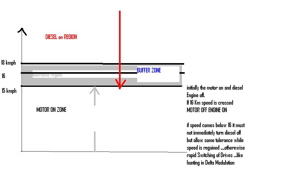

Hi
Designing a Motor/Diesel Engine Control System ...
the Require ments are
1.Electric Motor Should be Driving When the velocity is lesser than 15 Kmph
2.If velocity is greater than 15 Kmph the motor Drive is turned off and a Diesel engine is Started ...
3.If the speed of the Drive by Diesel Engine Comes Below 15Kmph with +/-10% tolerance Motor Should be turned on and Diesel turned off.
The Graphical Description is given below ....
Is it Better to use a Schmitt trigger or Go for Window Comparator .......But when Using Window Comparator the logic generated is whether the speed is inside tolerance range or not .....It's not sufficient to control the motor .....Could you help please ...

The same way you can construct a window detector you can construct a comparator with hysteresis, a simpler circuit usually named Schmidt Trigger, for which you can use a pot to set the values.
The System Power Should be low is the primary Requirement.
the output of the comparator is used to turn on and off a motor
the motor should be on until the voltage rises above 9v ......and above that level motor is off ...
During the reverse journey the motor Should be turned on only if voltage falls below 7.5 volt ....can a Schmitt trigger With UTP=9v and LTP=7.5 Do the trick ?
Yes, it can be done with the trip points you have choosen. Current consumption of a comparator circuit can go down to about 1mA depending on the IC you choose. You need to specify the supply and output voltages and currents needed/expected to get a more accurate answer.
the voltage levels Are
Output is used to turn a Relay via transistor ...the power supply used is 12v battery...Is 555 Ic enough for this or another IC ....? Current Output is a major problem .Inorder to make the things compact the cell used has lower Ampere/Hour rating ... AA cells as power source ...
the output is fed to base of a transistor with a relay ...and the relay Works as a Switch for the 120W motor ..
The 555 wouldn´t be my choice. There are many chips with less power consumption (unless you use a CMOS version). But, before going any further, does the coil of the relay get its power from the batteries? If so it is by far the component that consumes more power. Maybe a solid state relay can help in reducing power. Let us know what are the specs of the relay. Also, you should note that the batteries voltage change as they become discharged. You should have to use some kind of voltage regulator to get stable trip points.
Yes you are Absolutely right ......... relay used has ampere rating around 5A ....the Power Source for Motor is A bulkier Battery ...And the idea is to use Separate power source for the schmitt trigger side and relay/ motor side .....Also the output of the comparator is used to trigger a Monostable with width 3Sec Which is connected to the starter Switch of the Diesel Engine ......When the voltage falls below the lower trip point the supply to diesel engine spark plug is cut ....So three Control signals are generated as the output of Schmitt trigger ....
The general picture is
1.When System is just started -
Motor is on ,The Supply to spark plug is off,Monostable out to Diesel Engine Starter is off.
2.When Voltage crosses the upper trigger point ,Motor turned off,Monostable on for 3 sec for starter and Spark plug supply on
3.When the voltage comes below lower trigger point ,motor turned on ,and diesel is turned off by turning off the spark plug supply ..
We Intend to use 555 Cmos Version ...Is there any Better IC ?.....
