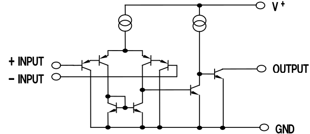

Oct 28, 2017 #1 D dashxdr Newbie level 6 Joined Jul 18, 2012 Messages 13 Helped 0 Reputation 0 Reaction score 0 Trophy points 1,281 Activity points 1,470 Can anyone tell me what the symbol is in the top of this schematic between the + power supply and the transistors? https://www.linuxmotors.com/2096.png Thanks!

Oct 28, 2017 #2 KlausST Advanced Member level 7 Joined Apr 17, 2014 Messages 25,166 Helped 4,868 Reputation 9,757 Reaction score 5,539 Trophy points 1,393 Activity points 168,389 Hi, It's a constant current source. Klaus
Oct 28, 2017 #3 D dashxdr Newbie level 6 Joined Jul 18, 2012 Messages 13 Helped 0 Reputation 0 Reaction score 0 Trophy points 1,281 Activity points 1,470 KlausST said: It's a constant current source. Click to expand... OK, that makes sense. Thanks!!! -Dave

Oct 29, 2017 #4 E ElectricalEngineering Junior Member level 3 Joined May 27, 2017 Messages 25 Helped 3 Reputation 6 Reaction score 3 Trophy points 13 Activity points 185 In your scenario it is constant current source as Kalus stated. Img: Sometimes it might refer to a transformer (especially in power systems).
