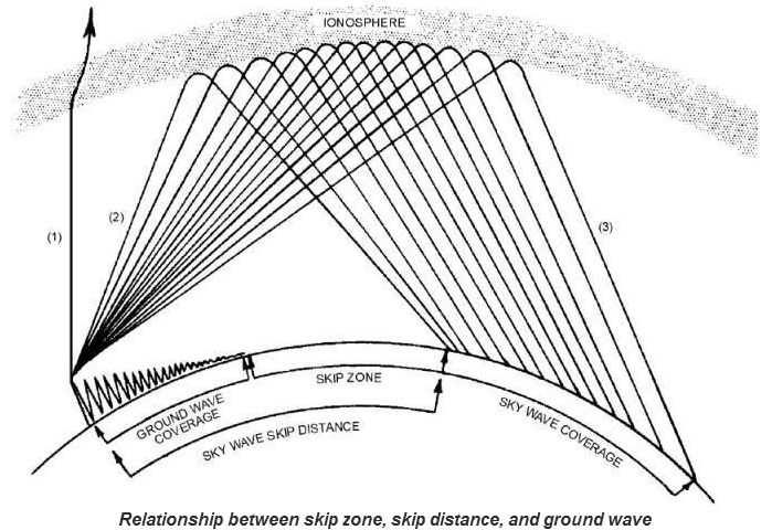

What is skip distance in wave propagation ?
it is the distance between the point at which the ground wave has been attenuated to the poitnat which it becomes unusable and the point at which the sky wave first returns to the ground and the signal beocomes usable again.
