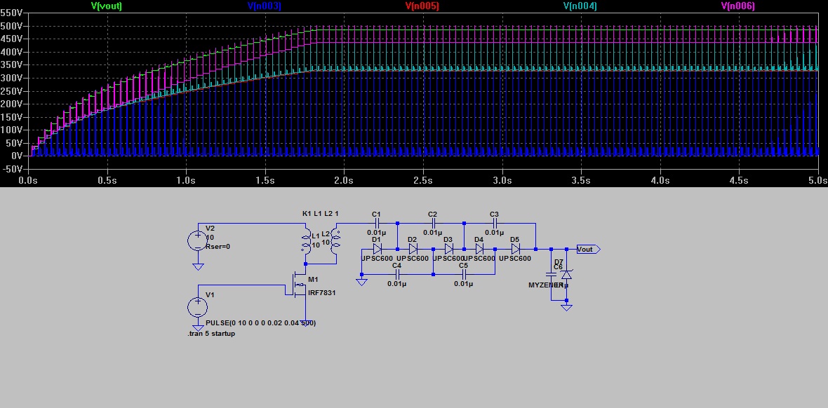

I'm developing a circuit that requires a voltage multiplier that can boost about 12V up to about 500V both DC. I had one solution based on a daisy chain of voltage doublers aka a villard cascade. I think I understand the basics of that approach but came across a circuit online that seems to multiply voltage in substantially fewer stages. I'm having some trouble analyzing it and was wondering if someone might be able to explain the theory of operation of such a design (also any limitations or pros and cons between the two shown).

Alright I spiced the first circuit out. LTSpice is nice!
Given the difficulty of making direct measurements (due to loading down), I decided to simulate the circuit. I took a wild guess on the transformer reactance though that I suspect could be way off. I am happy to provide the spice model for anyone interested.

Re: Voltage Multiplier Circuits - Need help with Theory of o
The transformer datasheet doesn't contain th einformation to calculate or even estimate inductances (main and leakage). You have to measure it.
I see, that the transformer has a rather high DC resistance. That's the price of the lower cut-off frequency requested for a telcom
application. I would prefer a transformer with less inductance and operate it at a higher switching frequency. It results in smaller
size and higher efficiency.
If you love low inverter frequencies, you may want to use a small mains frequency print transformer (e.g. 0.35 VA) in
reverse connection for your DC/DC. It already has a considerable built-in step up ratio and can easily achieve 500 V with a
simple doubler rectifier. It works best up to a few 100 Hz switching frequency.
