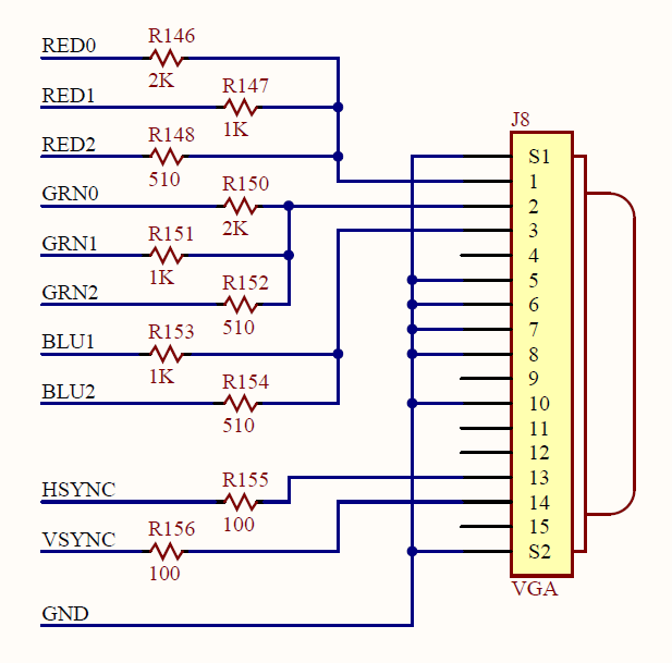

How can I do this? Do I need to solder external resistors?
You could do something similar to the attached schematic. The spartan-3E board I am currently using does precisely this. It uses 3 pins each for R and G, and 2 pins for B, so you get 8*8*4 = 256 colors.
Hope that helps!
Why only 2 bits are assigned for blue whereas red and green has 3 bits?

I tried using colour interlacing - but that was a bad idea due to low frame rate. If you want more colours - you'll have to solder something similar to post №7.

... If you connect the above schematic to a VGA monitor you destroy it. ...
If you mean the schematic I posted ... no it wil not destroy your VGA monitor. This is a working schematic, and so far it has not destroyed the monitor I connected to it. ;-)
Just calculate for 3.3 Volt CMOS outputs going into the resistors in the schematic I posted, keeping in mind that the input impedance on the monitor side is 75 Ohm (or up to about 100 Ohm including the vga cable). I am sure you will find that things do NOT go kaboom. :)
I'd like to agree on the "no-blow of the monitor" post, and ... The 3.3v max on anlog pic pins I think you belive is an issue I can only think that you are meaning the output won't get any higher than 3.3v because of the clamping.. I imagine the display may be a bit dim if you're only sending 3.3v to it but turning the brightness up would be OK for me to start...

I suspect that he means some sort of PWM or dithering approach. If you want to do that, you may want to take a look at the max frequency your PIC32 is going to be able to manage... For that sort of thing a CPLD/FPGA is a natural candidate. An microcontroller not so much. But hey, don't let me keep you from interesting tinkering experiments. ;)

Well, I'm an ex veroboard engineer at home. :p Anything except bga is pretty much doable with simple gear. The tip du jour would be to ditch the veroboards, and to use fully copper clad boards. Those are cheaper and give you better signal quality. :) And then do dead bug style (or manhattan style) construction. Like I said, cheaper and better (IMO). You have a nice continuous copper plane underneath all your components. And things like TSSOP with a 0.65 or 0.5 mm pitch are no problem, since you can bend the pins a little to give you room to work. The 0.5 mm QFN things do require patience though. :p
Anyways, the point is, if it's not BGA then you can prototype it at home.
And yeah, more pins for the resistor ladder will give you more colors. Dunno at what point it becomes impractical though. Personally I would maybe go to 5 resistors per color, but that's it. Not much use to put more effort into such a lowtech solution. If you want more better faster, then it might be time for a "proper" solution. ;) Such as an embedded board that has the whole video thing already figured out for you. :p
But as a learning experience it's pretty useful. :)
Yes, once your video requirements become sophisticated enough, you might as well use a specialised video DAC, like the ADV7123 or **broken link removed**, or move to DVI/HDMI.
