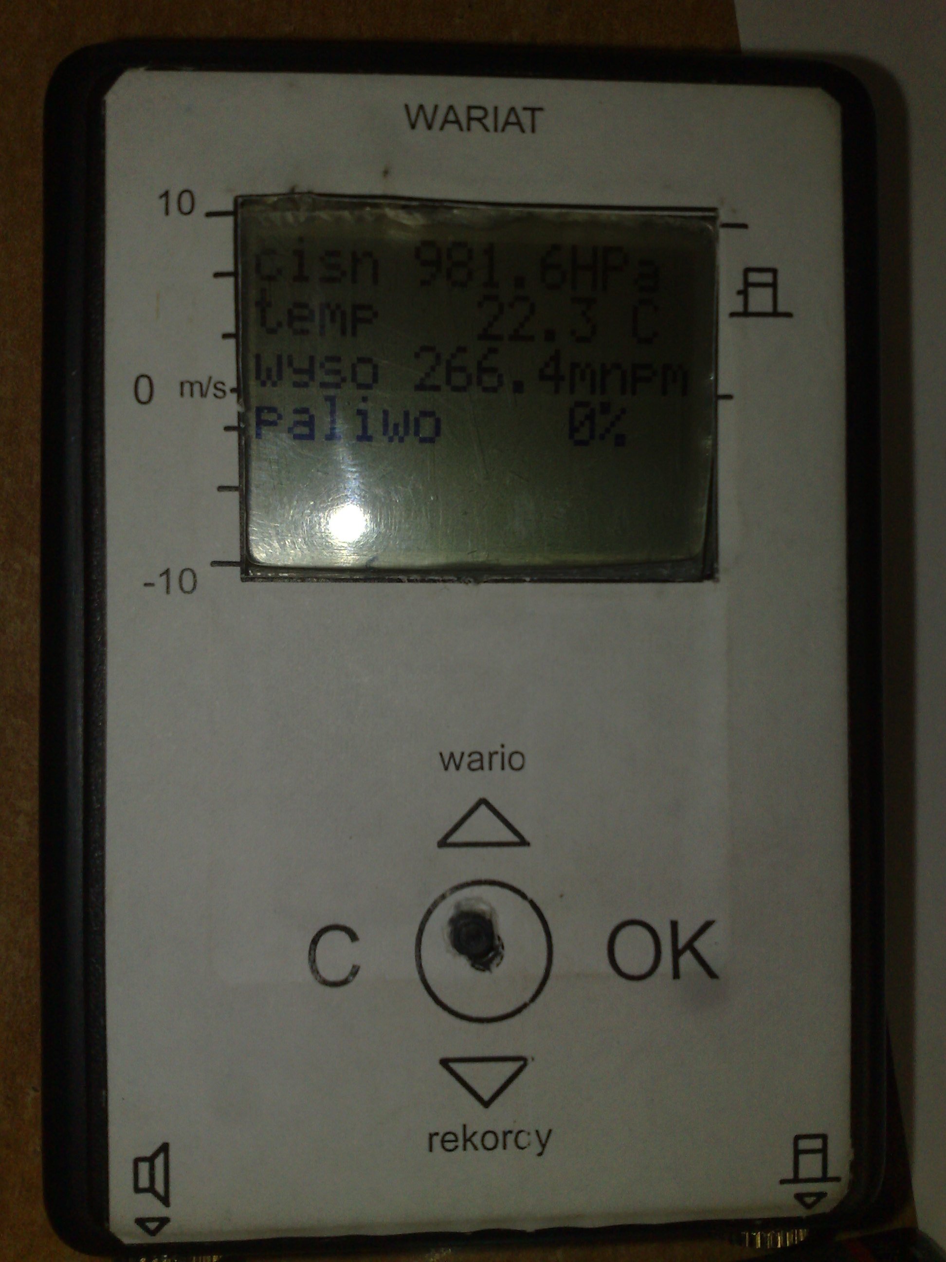

Resistance liquid level sensor was used to measure the fuel level. The measurement is done by the digitizer. To create a universal program, you can use the possibility of callibration by setting the level of Reserve (R) and the maximum level (F). The current measurement of the ADC is shown under the variable „P”.
The callibration is done in the following way:
Firstly, pour such a quantity of fuel to the tank, at which it shows the minimum state, and then press two buttons: OK + Down at once. After this operation, P measurement is stored to the variable R. After that, pour the maximum quantity of fuel and then press: OK + Up. Afer that, P measurement is stored to the variable F. Both variables are stored in the EEPROM, so you do not need to do that again.
7. Measurements:
All data from the measurements are displayed. Pressure and temperature are read from Bosh sensor BMP085, then the altitude is calculated.
