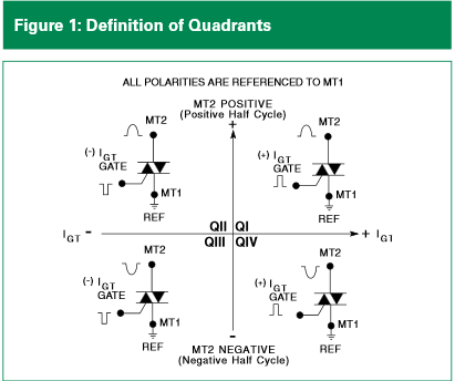

What quadrants are you triggering the triac? It is not specified at the IV quadrant.
I am using a posive gate pulse. So it would work in 3+ and 1+ quadrant.

Yes it is operating in the 1 and 4 quadrants. i am working with an AC load.
