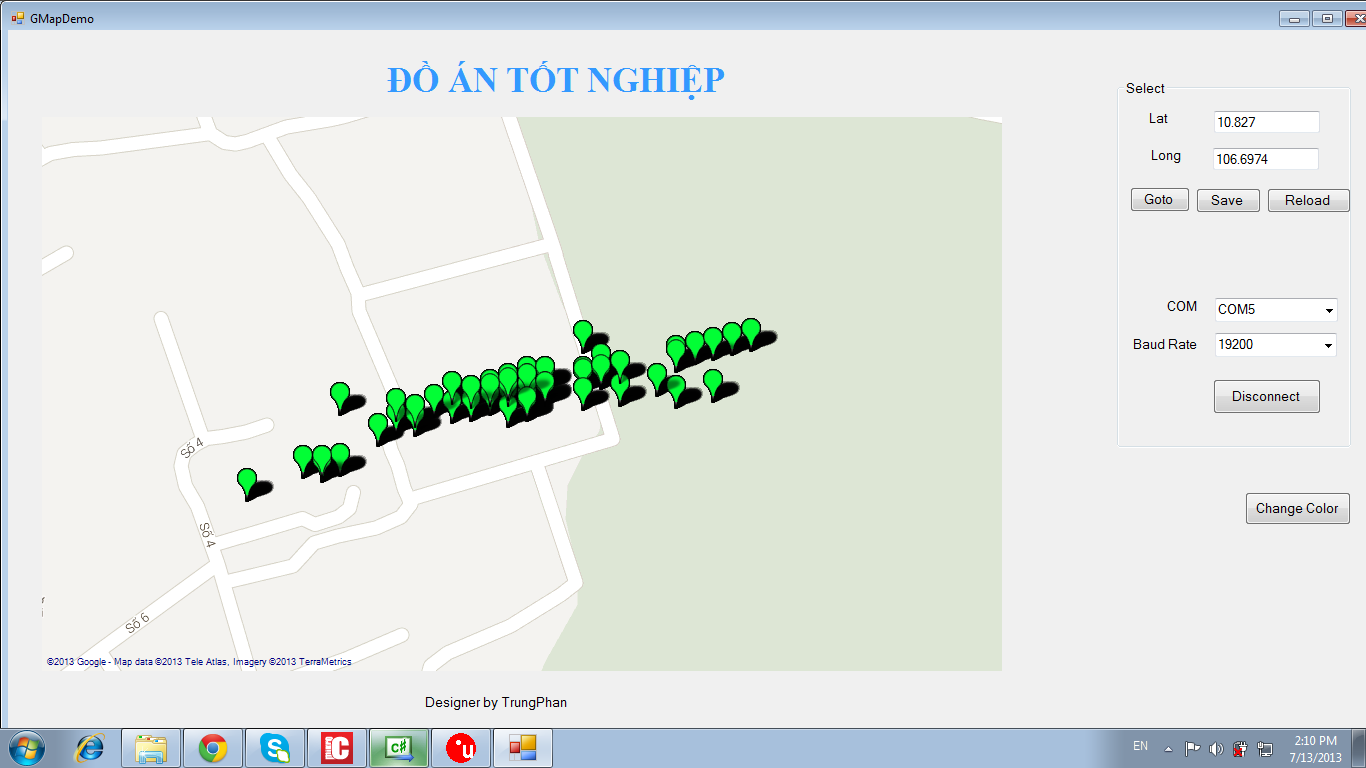

I test success to comunicate between nRF24L01 + PIC. :)
Now, i start find out of GPS by transceiver data using nRF24L01+PIC.:-D
