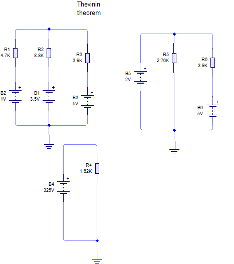

thevenin theorem please help
convert voltage sources with series resistors into current sources with parallel resistors and add currents and find equivalent res..then again use source conversion

I dont know how to do it can you show me one example please
