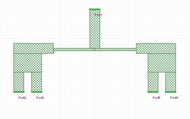

Whenever you change the pattern of your patches or strips in a T power divider your results are changed why??
Dimensions are kept constant still the results are changed???
why???
t power divider
Specifically, what pattern, dimension and results are you referring to ?

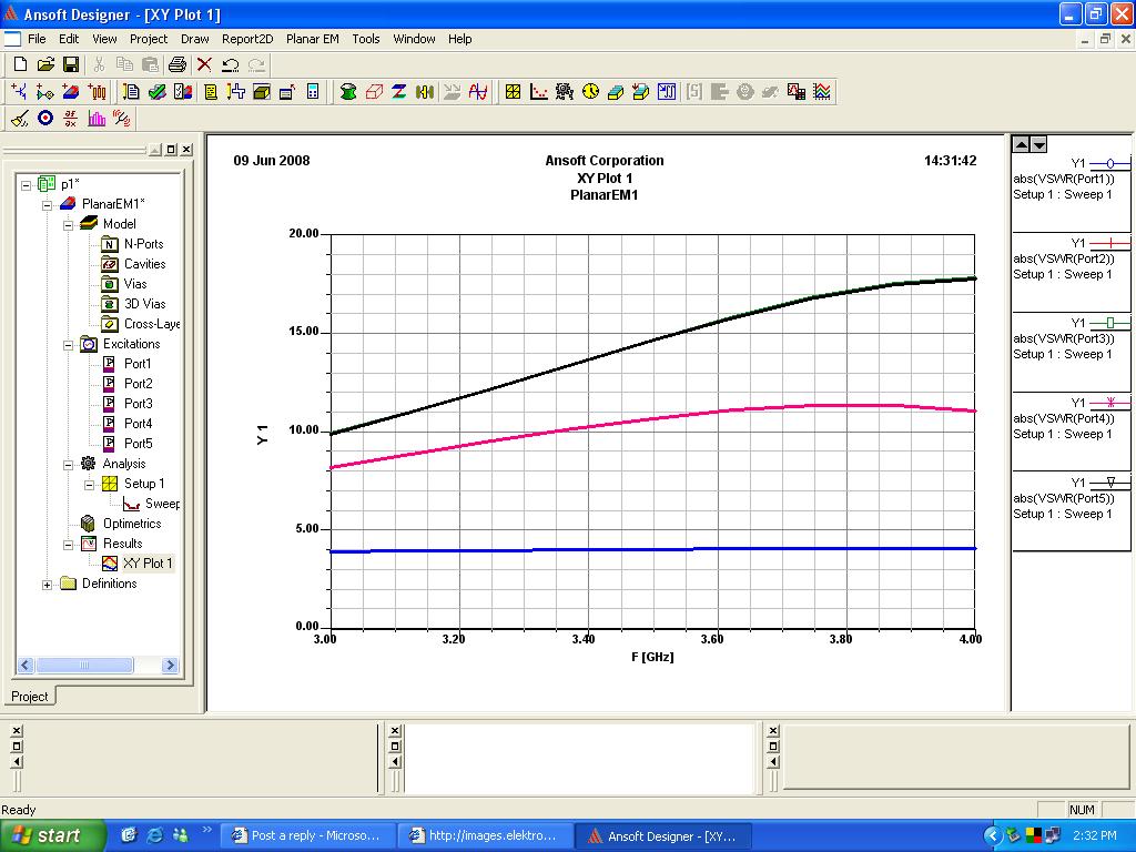

The results were as follows

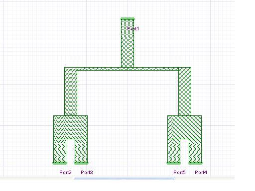

Now the dimensions of the patches are same but but theyve been aligned differently as follows
Now the results are different !!!!!!!
i need a solid reason ??why are the results changing???

I guess that your results come from an EM-simulation. In that case I do not see it as odd. Your structure is connected differently between the two setups and at 3-4 GHz the allignment of your conductors are not arbitrary.
The first case have two lengths and the second here the length is shorter but wider because they are put right next to each other.

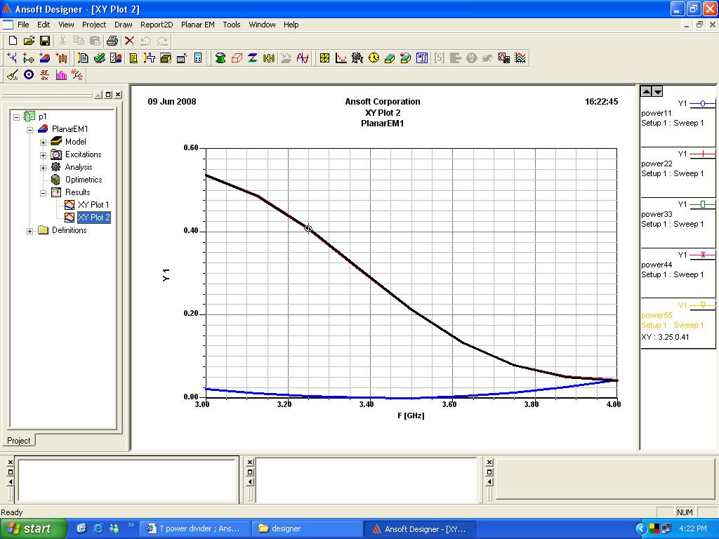

I cant figure out how to verify that my power is dividing correctly
i calculated the p11= s11*s11 graph vs freq and the rest s22*s22 ,s33*s33
and the values at my freq(3.5ghz) were for p11 0 and p22 0.27 ,p33 0.27, p44 0.27 p55 0.27
I cant figure out why the p11 is coming zero? where could be the fault???

If i'm not wrong, you should be looking at S12, S13,S14 and S15 to verify your power divider.

For a power divider our s11 ,s22 s33, s44 ,s55 should all be zero isnt that so??
while S parameters only telll you about incident and reflected powers
but what if a person wants to find how much power was input on port1 and how much of it came out at port 2,3,4 or 5
i calculated this by using the above formula which i got from ansoft designer manual for optim tee ??
if this is not the proper way then how should i verify my power divider that its working properly????
what should be my S parametrs if S parametes are used to check it???

You device cannot be lossless, reciprocal and matched at all ports at the same time.
The S-parameters tell you how much power is reflected and how much is transfered, i.e. S21, S31....
