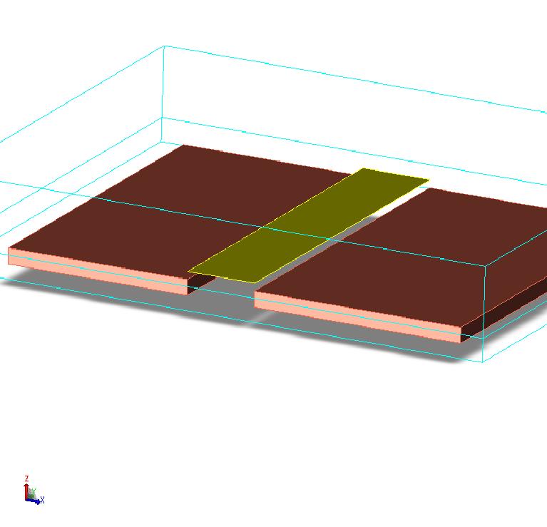

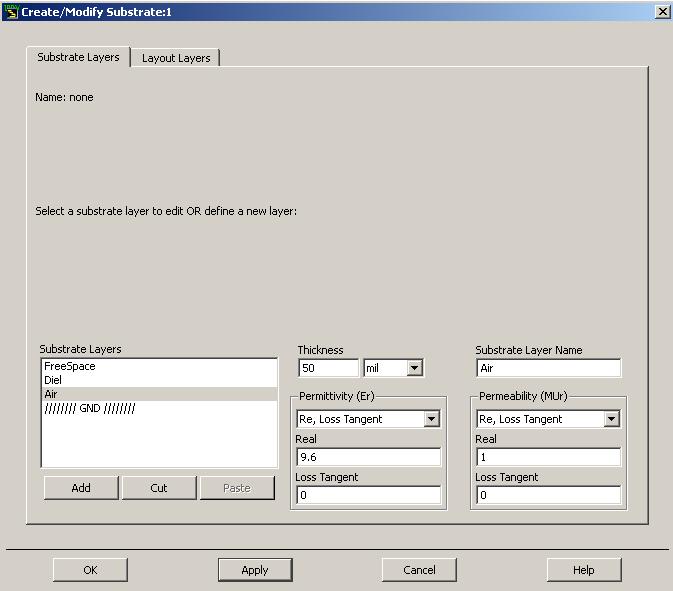

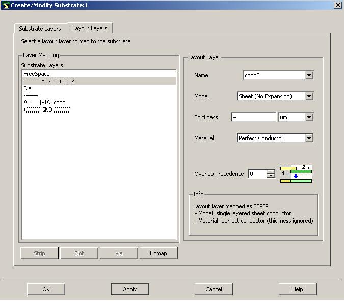

I would do build the Substrate stack-up as depicted in the attached snapshots. I also attached an EMDS preview whcih should look close to the structure you want to have.

Many thanks. It's that is necessary.
