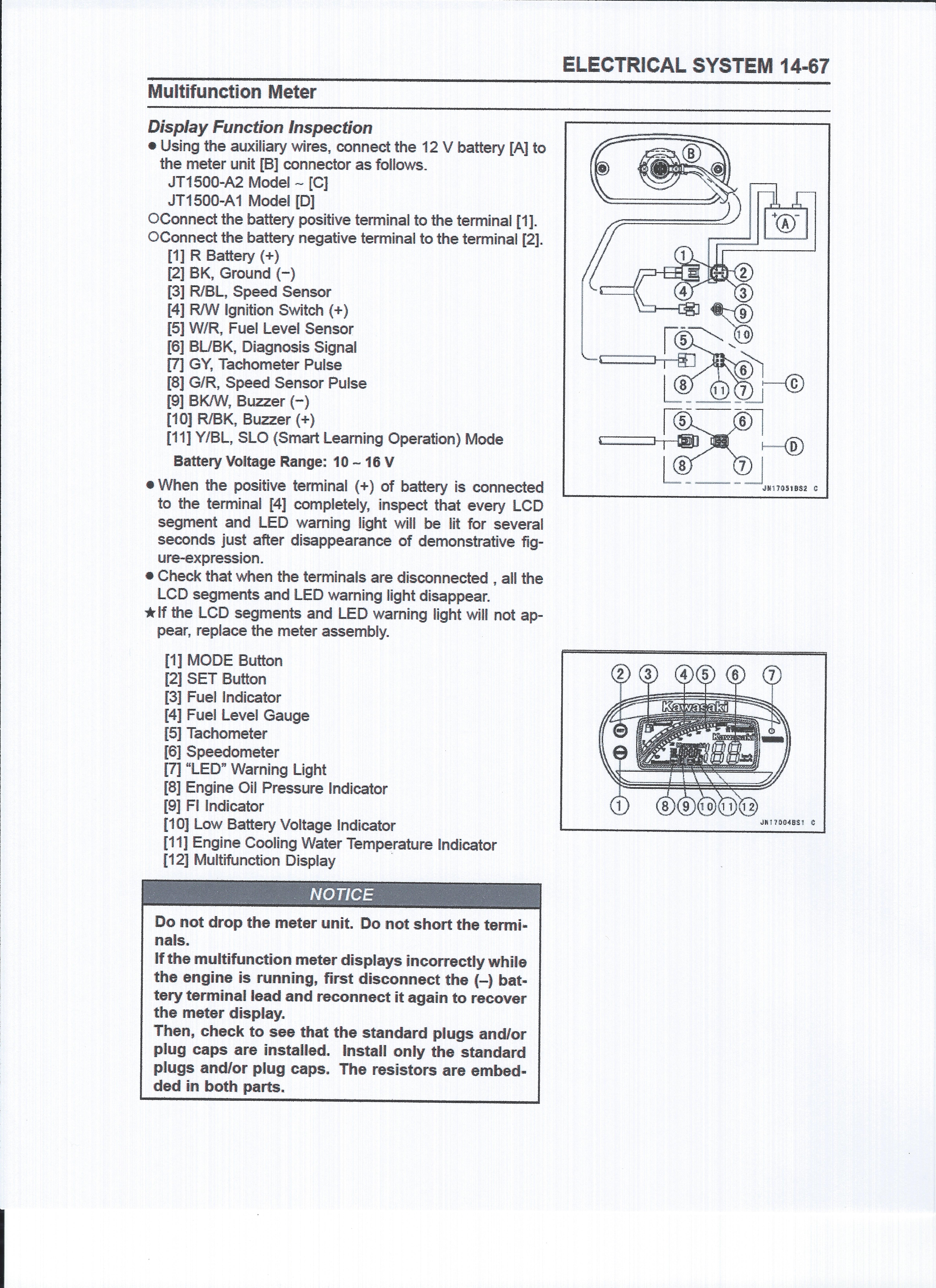

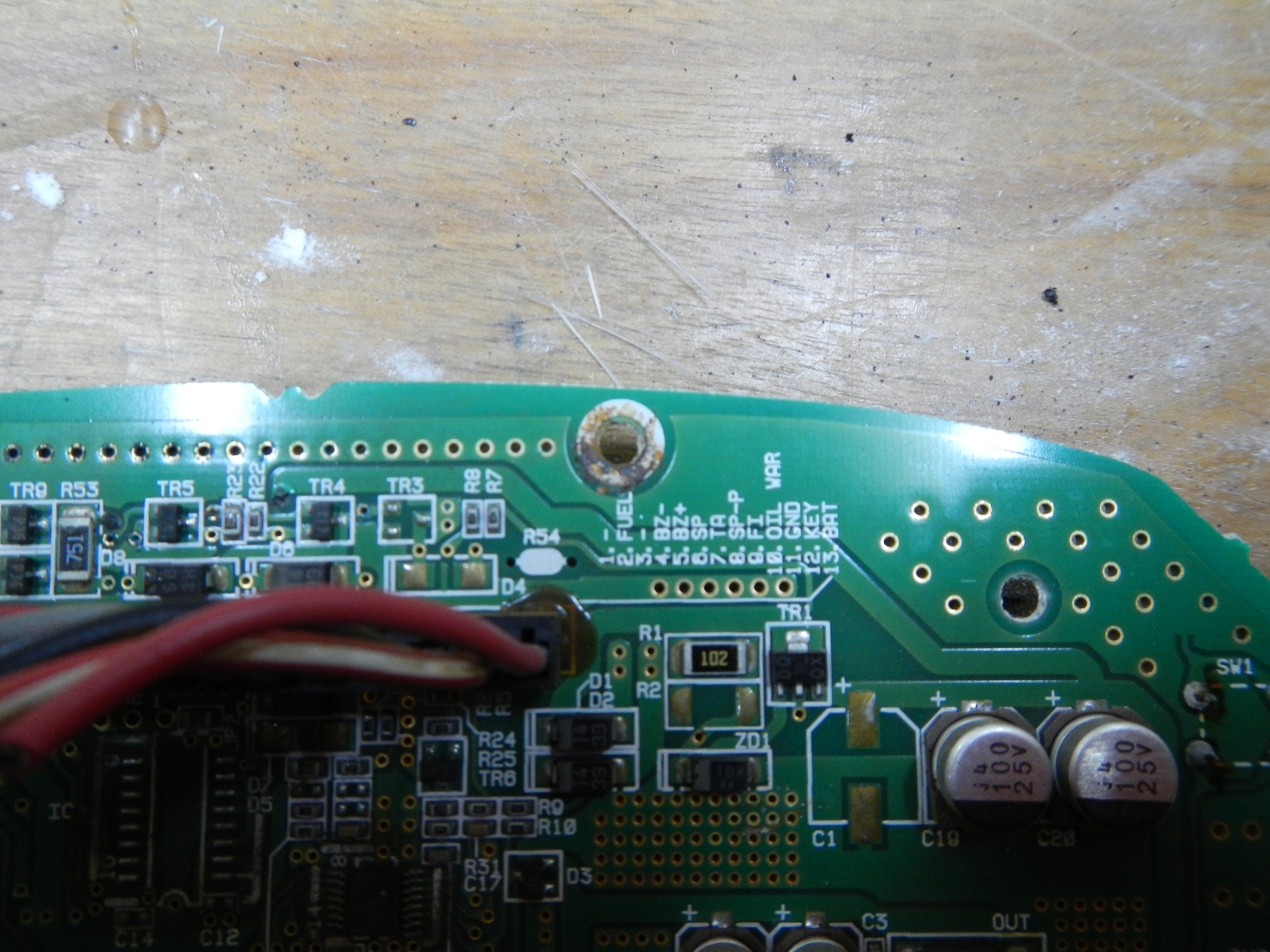

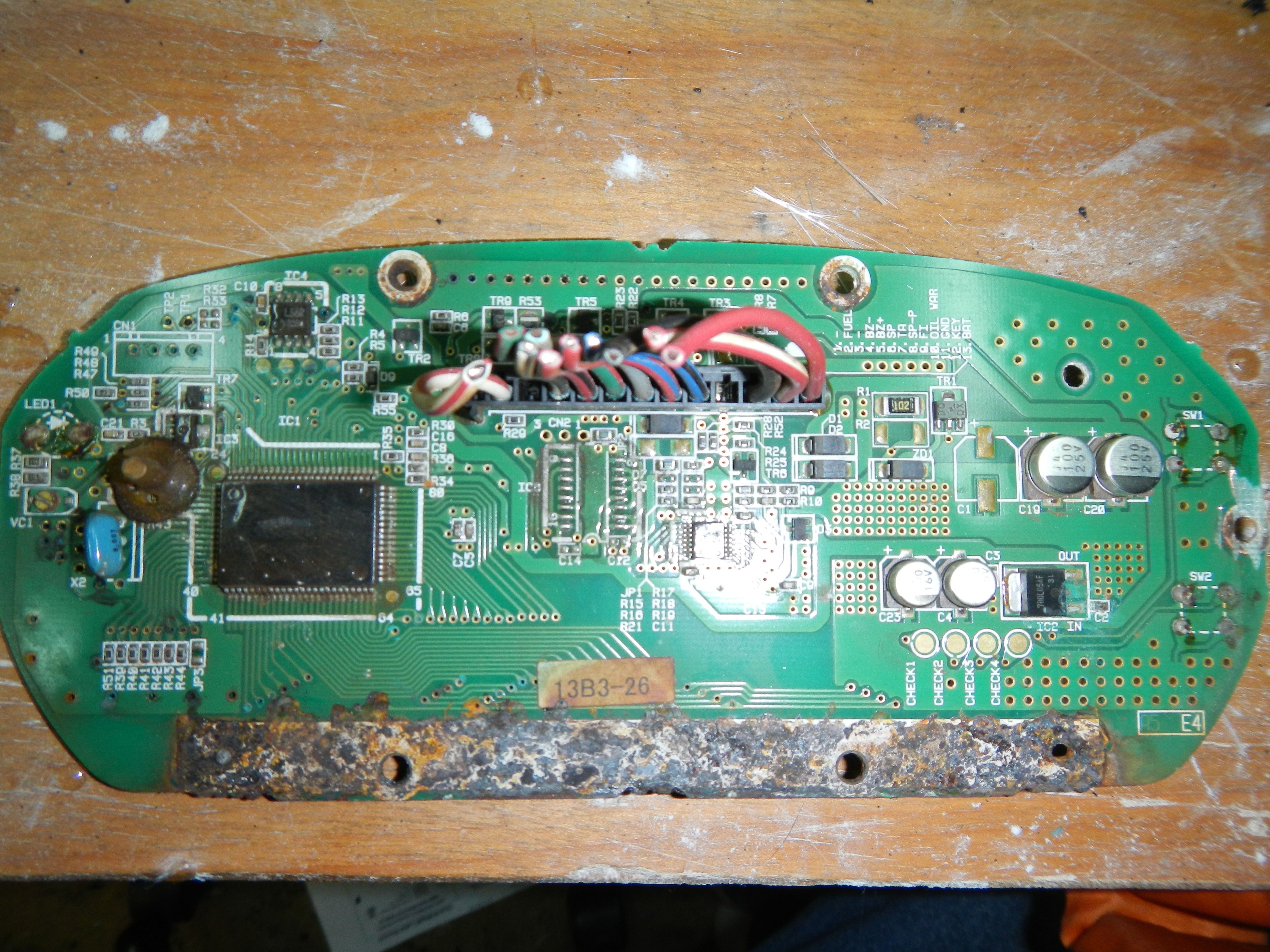

Not sure if im putting this in the right thread but i have a digital speedometer that the factory limits it to only read up 70 mph even thought it has the digits to go up to 199 mph. The speedo works on a 12v square wave and its input #6 red and green wire. Could someone please help me diagnose what is making it stop at 70 mph and help me find a way to make it read higher. Here are some pics of the board let me know what areas you might need a closer picture. Thanks for your help.
That chip is probably a microcontroller and if the limit is implemented in software there is nothing you can do (unless you manage to write the code from scratch and reprogram it)

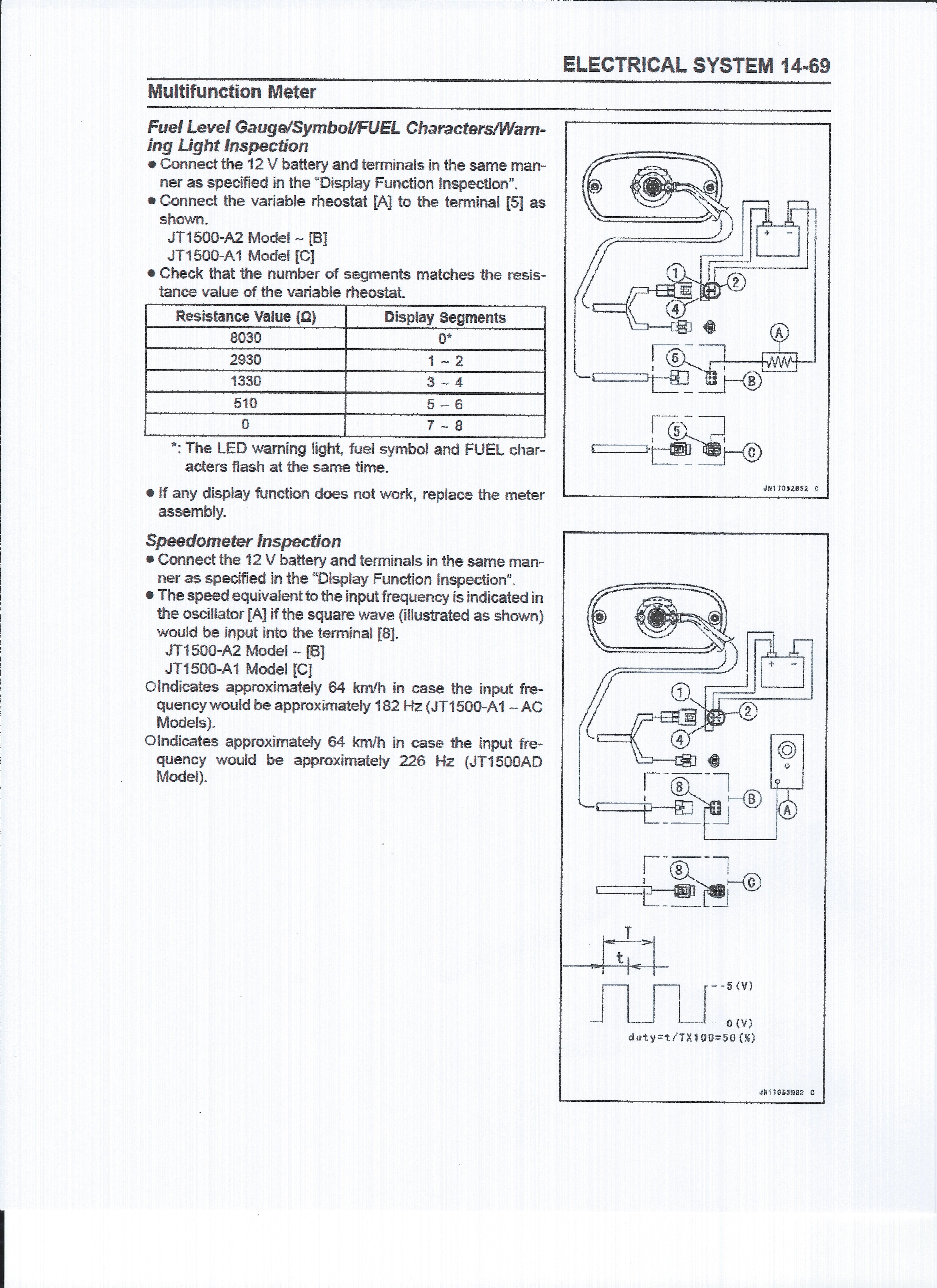

In a worse case scenario, you might make a manual "speed switch" that would make the indicated speed half of the true speed. To help you do that, we would need to know a bit more about the signal. Is the information in the square wave a function of frequency or pulse width? Does it increase or decrease with speed? For example, if it is frequency that increases with speed linearly, then it is a relatively simple matter to divide by two. If it is pulse width that decreases with speed, then one could stretch the pulses.
Added: Remember too, in modern cars, there may be other functions that depend on the speed sensor. Before attempting to adjust the meter reading as I describe, you will need at a minimum the wiring diagram to be sure you don't affect the signal for some other important function.

This is a gauge cluster out of a 2004 kawasaki jetski. From what i understand the manufacturers of pwc made a deal with the coast gaurd not to produce skis that would exceed 70 mph. Some models are limited to 67 mph, the limited on the speedo does not affect the actual speed of the ski. So just because the ski stops reading at 70 mph the ski can achieve higher speeds. There is no fix for this because most guys just buy a hand held gps for better accuracy, but i was able to wire the factory speedo into a univeral gps unit and it works perfect here is link to a demo video i made of it working off the gps unit. You will see its stops at 70 mph in the video. https://www.youtube.com/watch?v=yjPaidq4Pyo Im up for trying any fix possible to fix this the speedo does not affect anything else with the ski so a reprogram would be fine. i bought 2 broken gauges to take them apart thats the board you see in the photos. Its very difficult to open the cluster i have to cut it open to get the board out so a reprogram would be great. The square wave is a pulse width, im not sure if it increases or decreases with speed. The universal gps unit i wired into this gauge im not sure if i can alter its pulse wave. Here are the pdf manual files for this model. Thanks for the help let me know what else you might need to see.
The last page is surprisingly informative. For what you are doing, I think the easiest approach would be a divide by 2 circuit. If you search on that you will find mostly examples using D-type flip-flops and a few based on using the NE555/LM555 chip(s).

There are at least three locations on that board marked as being for option jumpers (and there may be more I didn't spot), no idea what they do, but maybe, just maybe.......
Regards, Dan.
Do you need better photos to see the jumpers? Maybe is good what should i try?
This speedo also reads km/h there is no way that i know of to switch between mph and km/h. I think that is preset by the factory i wonder if thats what one of the jumpers might do. There is also an hour meter for the engine run time not sure if a jumper might have something to do with that. Should i post help on this in the microcontroller thread?

I don't think so. You don't have the microcontroller source code and there is no way the manufacturer is going to give it to you. You can't write the microcontroller code from scratch unless you have complete circuit documentation and understood the function of every input and output to that microcontroller, and the manufacturer is not going to give you that information either. You could reverse engineer the whole circuit for a cost of about $500,000 if national security depended on it. But unless you have an extra half a million kicking around, I don't recommend trying that either. So far the best idea I have read in this thread is to find the tachometer pulse feed and insert a divide-by-2 circuit in it and live with a reading that is in miles per half-hour. That does not require any deep understanding of all the functions of the circuit. It just requires a good guess as to which line is the tach pulse line, and that you can do by probing around with a scope in a few minutes, if you don't already have that line identified.
