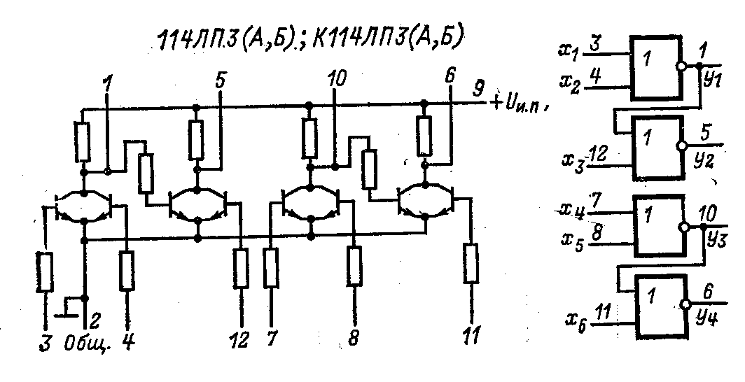

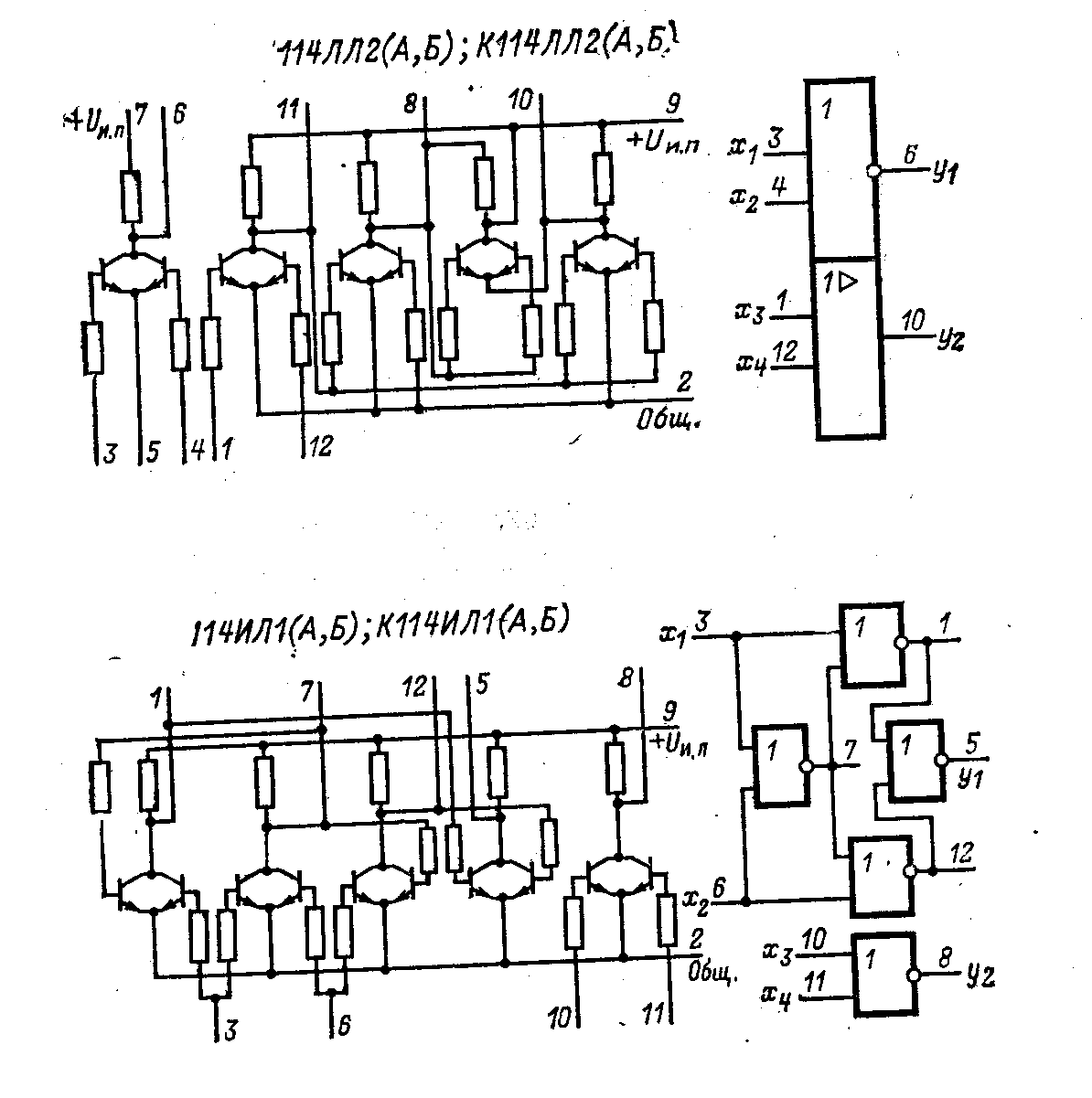

Dear Friends,
I'm seeking for pin out configuration of a number of Russian RTL ICs, which are known to be obsolete. Fortunately, one of EDA users, has provided me with such pin outs for two ICs, (See the last item in the following post):
I have urgent need to access to such pin out configuration figures, as with the above mentioned post, for a few number of ICs, amongst them are
1. 114ЛЛ2A
2. 114ИЛ1А
3. 114TP1A
4. 114ЛП3A
Thanks in advance,
msTalebi.
Re: IC Pinout is needed
Here you are:
