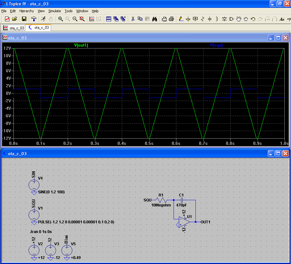

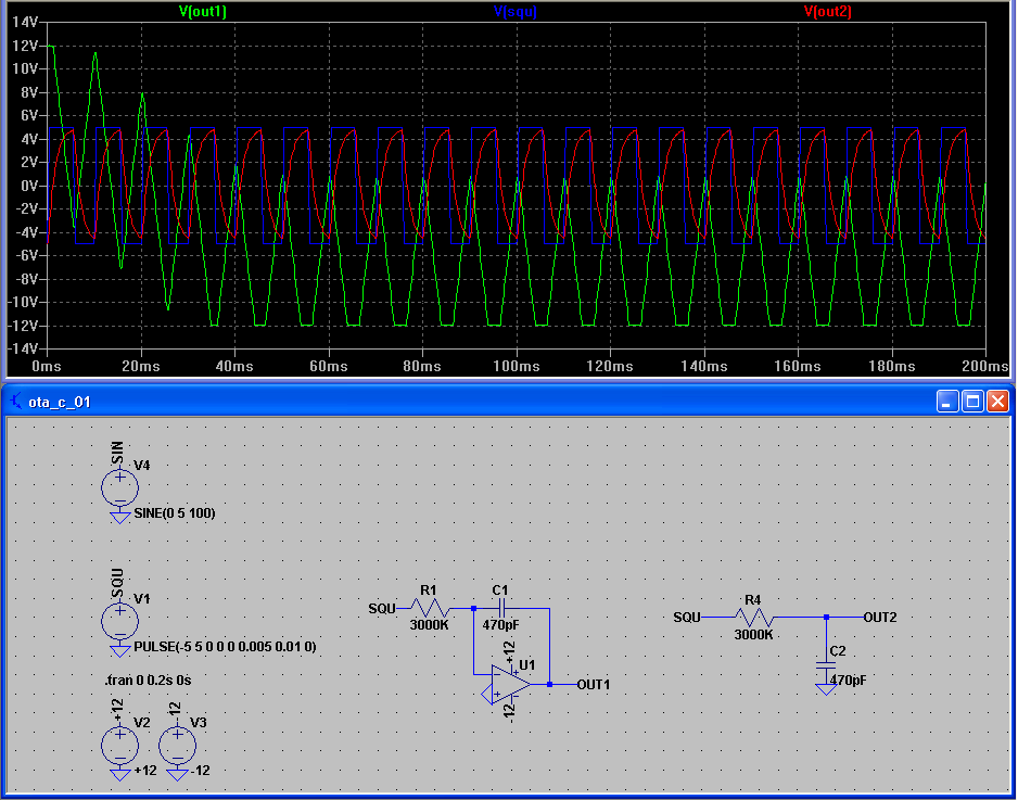

Hello,
Can anyone explain the behaviour of this integrator simulation - it's not as I expected.
There is an active and a passive integrator, they both use a +/-5V square wave @ 100Hz as the input.
The output of the passive integrator is doing what I expected - but the output of the active integrator swings down between the negative rail and 0V - why is this?
I also notice that if I use a 100Hz Sine as the input - the signal goes straight to 0V to -12V - why is this?
Thanks!
