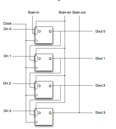

Hello gurus, i'm new at VHDL programming, i have to create a Scan Chain from scratch, and starting from this one i have to test a Component.
I created first of all flip-mux, a component that combine a D-latch flip flop and 2-1 Multipliplexer.
My scanchain is composed by 4 flip-mux, when Scan_en is disabled, the scan chain output is the input Din0, Din1,Din2, Din3.
I implemented my scanchain, I need to create the "Component".
I was thinking a simple 1 bit adder, for example:
if the output string is -> 0 0 1 0
after the string goes into the Component the exit will be -> 0 0 1 1
To implement this i've created a new vhdl module that has 4 input and 4 output, now how i can handle the scope of my scanchain variables, to implement my component?
You will also need clock, scan-in inputs and scanen and scan out outputs. So thats 6 inputs 6 outputs total.

Ok thanks for the advice, anyway i have a problem in Component Sommatore when i try to call variables defined in other components.
You don't "call variables" in structural VHDL design, just connect components. As said, it can't be seen how you did it.
It's done right in entity fm, I would expect similar component instantiations in the entity Sommatore.

You are repeating the code snippet you posted before. It still doesn't seem make sense to me. Post the complete architecture with signal definitions and component instantiations.
We can refer to the entity boundscan which essentially contains the required design.
The outputs u0 to u3 of the fm component instances are now unconnected.

It can be corrected this way:
completely delete the process, all required logic is already in the component instances.
assign the outputs in concurrent code
dout0 <= u0;
dout1 <= u1;
dout2 <= u2;
dout3 <= u3;
Scan_out <= u3;
