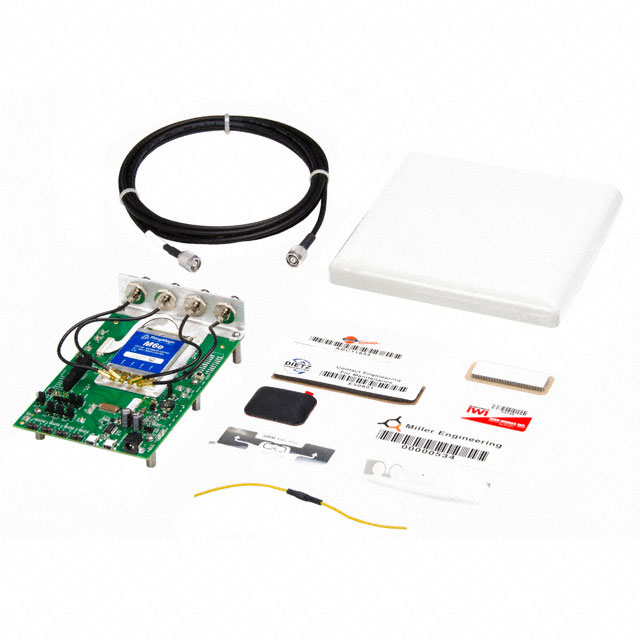

Thingmagic offer already constructed development boards and an express platform
which are essentially what I am after (albeit in an enclosure), but again they aren't that cheap, and you can't get the schematics for them (makes sense really) unless you have bought one.
A datasheet and integration guide for the M6E can be here.
I think essentially want to recreate the dev board seen in the link below, aand I guess put it in an enclosure as well, so that it could be used to time a race alongside 4 antennae and hook it via usb cable and attach it to my PC. I think I can actually use their API to write the software I need.
