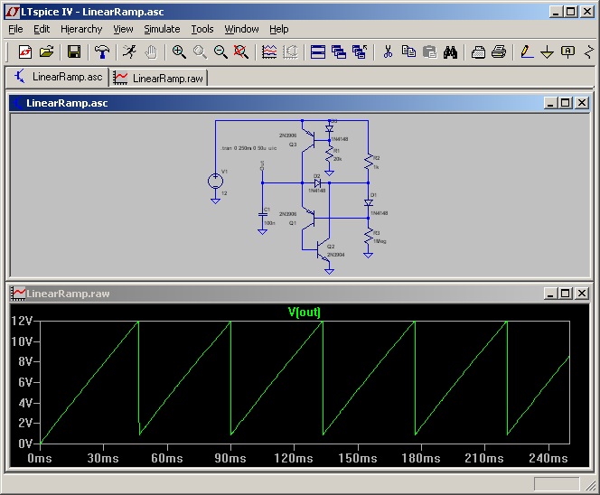

Here is a true linear ramp designed by me quite awhile ago based on the same concept, although the peak is not really sharp, R1 can be adjusted for a wide range of freq, Sim looks good, in practice, I have not tested it. Just in case you might be interested.
Where do you get the output from?
at the cap, junction of Q3's E and Q1's C
PS: If you want a fuller swing, voltage divider can be set to 100k/10k ect...

Are you using the exact components and voltage as in crutschow's drawing? Because if the applied voltage is lower than 12V, noticeable non-linearity can be seen from LTSpice sim. This method, bootstrapping discharge, will not give you a true linear waveform.
