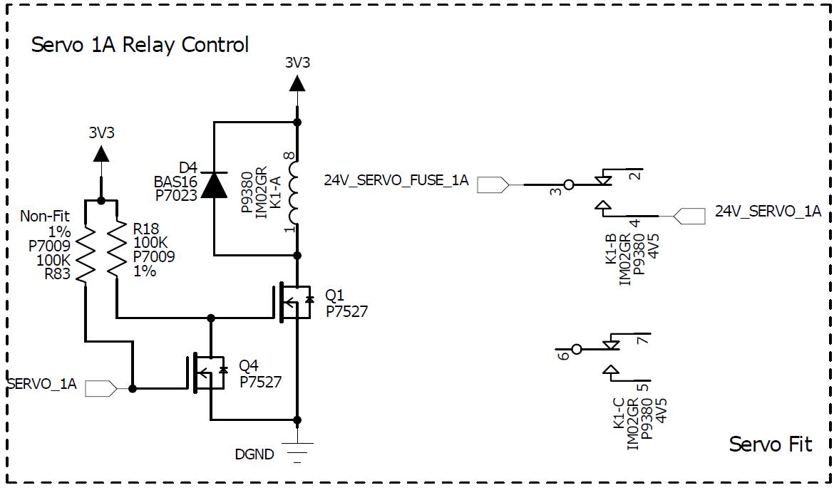

Can any one please suggest me how to change a relay from polarised to non polarised. I am using IM01GR and I swapped the pin 1 and 8. the relay is not working when I power in the wrong direction. I have created the PCB and I could not able to find a non polarised relay of same pin shape and size. Can any one suggest me a replacement for the above relay model or a non polarised circuit.

Can I please know will I be able to use a latching relay in my circuit and make it work without cutting tracks and by altering connections ?
I have attached relay circuit diagram. Pin 1 has to be 3V3 and pin 8 had to be connected to the transistor.
https://obrazki.elektroda.pl/6670871300_1380803079.jpg
Latching relays are a special version of polarized relays. They either have two coils or need voltage of both polarities applied to a single coil. Obviosly the posted circuit can't do this.
Polarised relays have latching properties even without power. Direct replacement by non polarisedwould not work.
