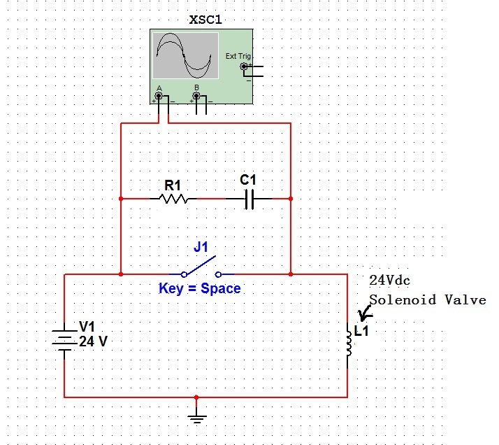

Hi guys,
From what I read they said there is leakage current in RC snubber when it connects parallel with switch.
But in simulation, the ammeter doesnt show any leakage current.
Anyone has any practical experience for above case?
If I want to build the circuit as shown above any type 100ohm resistor and 100nF capacitor will do the job right?
Thanks
I guess, you have read about leakage with AC supply. There's no leakage current for DC.
ok, this makes sense. thanks FVM

FvM, maybe I'm missing something, but why do you say there will be no leakage current? The capacitor will have some parasitic parallel resistance which will allow some leakage. It may not be modeled in circuit_freak's simulation so he doesn't see any, but in practice wouldn't you expect to have some?
Yes, some leakage. But in my opinion, we should focus on currents of practical relevance.
You'll find specification for typical leakage resistance values of foil capcacitors in a 10^11 - 10^12 ohm (Teraohm) order of magnitude. Thus it's questionable, if the PCB surface, the relay contact or the capacitor have a higher leakage current. Most likely, the PCB surface.
FvM, yes I absolutely agree it's practically negligible. I just wasn't sure if the OP was looking at it from a theoretical or practical standpoint, since he was discussing a simulation.

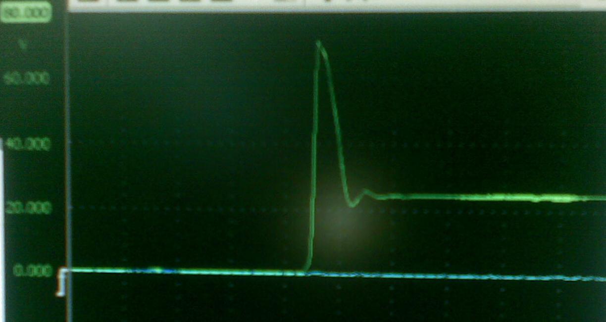

hi, i have build the circuit to switch a 24Vdc solenoid valve as shown previously.
when the switch open i can see a voltage transient to around 70V using oscilloscope.
waveform as shown below.
But when i install a RC parallel to the switch the spike remain (no changes at all)
I did try with various value as below but no luck the spike still there.
R (Axial-lead Resistor - 150ohm, 100ohm, 47ohm & 22ohm)
C (Ceramic Disc Capacitor - 0.1uF & 0.01uF)
did i miss out something?
thanks in advance.
There are two possible reasons:
- The snubber resistor is too high related to the the load current. 22 or 47 ohm sound reasonable, however.
- The capacitance is too low related to the load inductance (L/R time constant).
P.S.: You may want to tell the timebase for the waveform.
Circuit_freak, what is the scope trace showing (motor, switch)? You mentioned this transient happens when the switch opens. If so, I would agree with FvW that your values should be adjusted, and you might also want to try using a diode snubber in addition to (or instead of) the RC snubber. This is essentially a flyback diode reverse-biased in parallel with the motor. If your scope trace is showing the motor voltage (the transient is coming when the switch closes), maybe it's inrush current and perhaps a series inductor would help.

    FvM
hi, my circuit is as below.
The probe is connected parallel to the switch and RC snubber.
and the current flow to the solenoid is around 17mA.
Transient shown previously happens when the switch opened.
FvM - i have forgotten the timebase will check and update you.
so ill stick with 22ohm 0.5W resistor and try with 1uF & 10uF (radial capacitor) later.
ARQuattr - i tried diode snubber before and it was great, and i wanna know more about rc snubber that why this circuit is made. :-D
