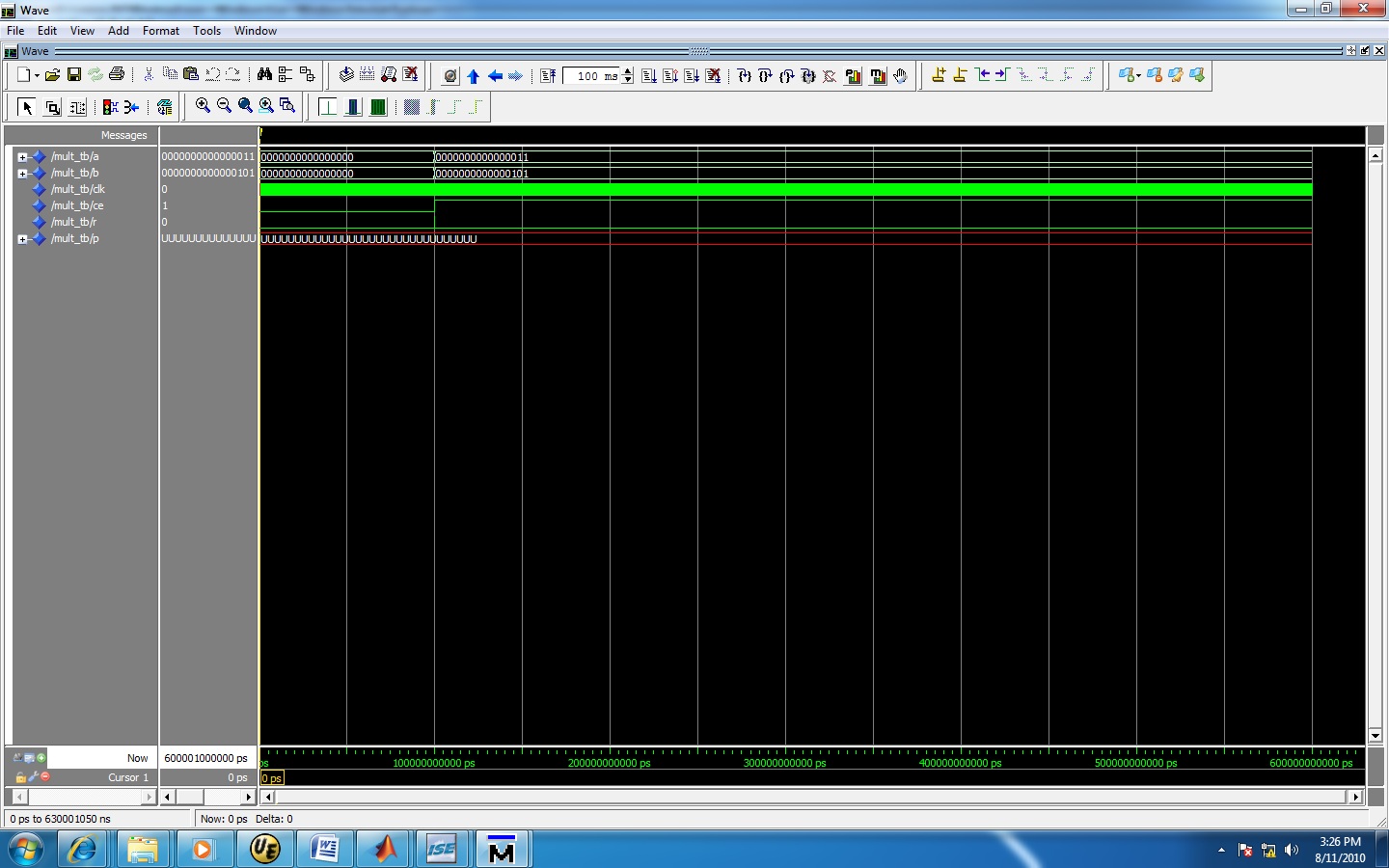

Aug 11, 2010 #3 U usamaaslam1 Newbie level 6 Joined Aug 21, 2009 Messages 11 Helped 0 Reputation 0 Reaction score 0 Trophy points 1,281 Activity points 1,355 can u send me a link from where i can get windows 7 compatible MODELSIM and its licence????? Added after 5 hours 37 minutes: here is the ouput waveform that i am getting in my simulation
