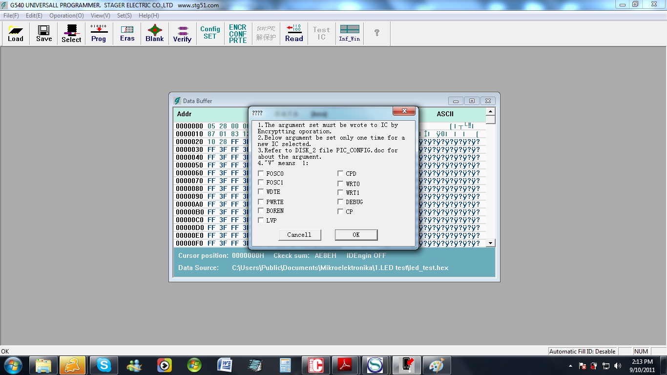

I have no idea of the programmer you use, but I think that you need to set the config bits in the programmer software which (maybe) can not read the config bits from the HEX file. This happened with my TOP2005 programmer before. Download the PIC16F876A datasheet and go to the configuration bit settings (page 146).
FOSC0 = 0
FOSC1 = 1
WDTE = 0
PWRTE = 1
BOREN = 0
LVP = 0
CPD = 1
WRT0 = 0
WRT1 = 0
DEBUG = 0
CP = 1
Set these in the configuration menu.
Hope this helps.
Tahmid.

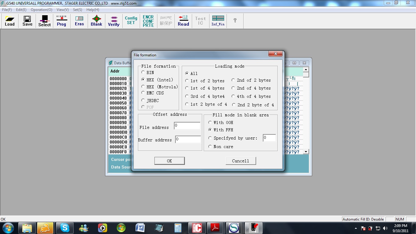

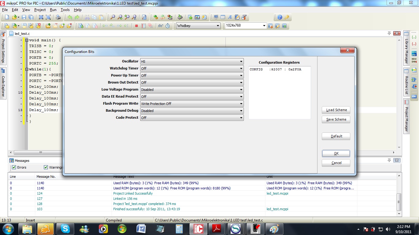

Thanks for the reply Tahmid. So should i set these values in the mikroC also or just in the programer software?
Well i set it in both but programer still gives error of "NO word configuration in HEX file". Anyways i forced the program to burn and it worked :)
What programer are you using and what compiler are you using MPLAB or MikroC? Since I am beginning so its better to have an experienced suggestion.
Anyways thanks again and do me a favor, link me a tutorial (easy1 and step by step) or a good eBook if you have it.

According to datasheet,most suitable for this burner in start is setting for the reading content allowed (code protection disabled)
If you enable code protection, when you read back,youu will see only zeros. you think it is not programed wright.
Actually programe is there and if ok then it will run.
If you ser code protection disabled ,you will see the actual code in memory. and you confirm programmer is ok.
FOSC0 = 1 hc osc
FOSC1 = 0 hc osc Above 4MHz HC setting is used
WDTE = 0 disabled Watchdog timer if not took care off in software, will continually resets the microcntroller .
PWRTE = 0 disabled Initial delay timer for oscillator to get stabilized.
BOREN = 0 disabled Brownout, when power supply drops below certain level, it resets the microcntroller.
LVP = 1 disabled Low voltage programming disabled, as two i/o used and programmer can do otherwise
CPD = 1 disabled protection disabled so data in eprom can read back
WRT0 = 1 disabled Write protection off
WRT1 = 1 disabled
DEBUG = 1 disabled Debuger disabled
CP = 1 disabled Programme data can be read back
So cofig word is,
B'1111100111010'
You may try other settings but oscillator settings are important.
When both bits are cleared, it is set for LP. 32KHz to 200KHz
range.
Now about programmer,
Every time you load a hex file. a pop up dialogue say ' None configuration word in hex file. Please set it after loading'
It is chinese english. Actually you have already loaded the hex file. It also means after this session when next time you are gonna programe, dont forget to set the config bits. But dont worry next time this pop up will be there. But then when you observe config bits, your previous settings will be there. So you will soon start ignoring this message. Its funny after setting the bits, you think it is necessary to reload the hex file. When you do so ,message reappears and now you are confused. After setting the bits you only have to click Prog. and next time you burn hex, just forget it, click ok and then click Prog. The old settings will be there for that chip.

Port B is blinking but RB6 and RB7 are not working. LVP and debug mode is off. I have read on a form
RB6 and RB7 output not working
That its good to define config bit in your source code so it will over ride the programmer settings. Unfortunately i never found the regarding example in Mikroc.
Well if there is something else wrong, plz let me know.
In mikroC, you don't set the config bits in the code. Setting them as you have done using Project > Edit Project essentially does the same thing. However, your programmer seems not to recognize it. Didn't you set debug and power up timer off in the config settings?
Debug is set off and power up timer was on in both software and hardware---->NO good.
After that i set off the power up timer (debug off)in both software and hardware---->no good

Got it working...my mistake. I was thinking Debug mode off at "0" but it is off at "1".
