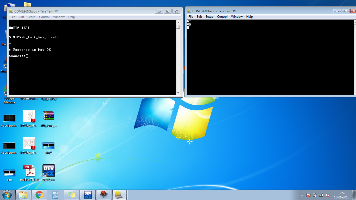

I am interfacing sim908 with atmega1281.
I am sending commands to sim908 via tx-rx pin. As i send "AT" it responds "OK" but somehow i cant able to receive that "OK" inside the mcu. By receiving that "Ok" i can go further steps in code.
In my hardware connection i connected sim908 with UART1 and displaying its response on hyperterminal via UART0.
So please look my code and reply me where i doing mistake.
Here i had attached hyperterminal's snapshot for your reference.

AVR Studio - Compiler i am using for ab above task
I have also tried by removing bits "(1<<RXCIE0);" and "(1<<RXCIE1);" from the uart init part, but though also i achieved desired result.
maybe hyperterminal adds "Cr/Lf" after the "AT".
Klaus
so for that what should i have to change?
Even i want to just print echo as it is....but as you can see in picture its total blank after "="
Try to send "AT" & [Cr] & [Lf].
Klaus
Klaus
Will you please tell me...that to send AT with Cr+Lf..what exactly i have to pass?
Hi, KlausST..
I have try to send it...as you suggested but still the result is not as expected
here is my code and result at (https://obrazki.elektroda.pl/7379318800_1465543513.png)

	_delay_ms(10);
void flush_UART1(void)
	uint8_t t_len = 0 ;
	char t_buff = '\0' ;
	uint8_t head, tail;
	head = rx_buff_head;
	tail = rx_buff_tail;
	if (head >= tail)		// Data present
	t_len = (head - tail + 1);
	else					// Data present, start has rolled over
	t_len = (RX_BUFF_SIZE - tail + head + 1);
	while(t_len-- > 0)
		t_buff = rx_buff[rx_buff_tail++];
		if(rx_buff_tail==RX_BUFF_SIZE)
		rx_buff_tail=0;
	t_len = 0;
	while (t_len++ < RX_BUFF_SIZE)
		rx_buff[t_len] = '\0';
	//	tx_buff_head = tx_buff_tail = 0;
	rx_buff_head = rx_buff_tail = 0;
	_delay_ms(50);
void sendstring_UART1(char* buff)
	// Loop through the data
	while(*buff != '\0')
		while ( !(UCSR1A & ((1<<UDRE1))) );	// Wait for empty transmit buffer
		UDR1 = *buff++;						// Start transmission
		_delay_ms(5);
void send_SIM908(char* cmd)
	//uint8_t d_len = strlen(cmd), i = 0;
	if( checkavail_UART1() != 0 )
		flush_UART1();
	for(i=0; i<=d_len; i++)
		putchar_UART1(cmd[i]);				//transmit the user string
	sendstring_UART1(cmd);		_delay_ms(50);
	//sendstring_log("\r\nfrom sendSIM: ");	//sendstring_log(dummy_buff);
void USART_Transmit1( unsigned char data )
	/* Wait for empty transmit buffer */
	while ( !( UCSR1A & (1<<UDRE1)) )
	/* Put data into buffer, sends the data */
	UDR1 = data;
unsigned char USART1_Receive( void )
	/* Wait for data to be received */
	while ( !(UCSR1A & (1<<RXC1)) );
	/* Get and return received data from buffer */
	return UDR1;
void sendstring_log1(char* str)
	sendstring_UART1(str);	_delay_ms(500);
ISR(USART1_RX_vect)
	_delay_ms(100);
	sendstring_log0("\r\n\nTEST1\r\n"); _delay_ms(10);
	for (int i = 0; i<10; i++)
		data_in[data_count] = UDR1;
		data_count++;
	sendstring_log0("\r\n\nTEST2\r\n"); _delay_ms(10);
	sprintf(aux_buff, "\r\n\n==%s",data_in);	_delay_ms(10);
	sendstring_log0(aux_buff);
	data_count=0;
void read()
	for (int i = 0; USART1_Receive!='\0'; i++)
		data_in[data_count] = USART1_Receive();
		data_count++;
	data_count=0;
void ReadStringData(void)
	sendstring_log0("\r\n\nTEST8\r\n"); _delay_ms(10);
	for (int i = 0; i<buff_size; i++)
		data_count++;
	sendstring_log0("\r\n\nTEST9\r\n"); _delay_ms(10);
	data_count=0;
	sendstring_log0("\r\n\nTEST10\r\n"); _delay_ms(10);
// Receive a byte
void getchar_UART1(char *data)
	*data=rx_buff[rx_buff_tail++];
	rx_buff_tail=0;
	_delay_ms(10);
void get_SIM908(char* reply, uint8_t len)
	//char dummy_buff[100] = "\0";
	//memset(sim_data, '\0', 100);    // Initialize the string
	//sendstring_log("\r\nfrom getSIM: ");
		for(uint8_t i=0; i<len; i++)
			getchar_UART1(reply++);
			//send_log(*(reply-1));
	_delay_ms(50);
	//strcpy(dummy_buff, reply);	sendstring_log(dummy_buff);
int main (void)
	unsigned char ch="/0";
	unsigned char dup[10]="/0";
	unsigned char sim_resp[20] = "\0";
	//static volatile uint8_t rx_buff[10];
	char rx_buff[10]="\0";
	init_UART0(); _delay_ms(10);
	init_UART1() ;_delay_ms(10);		// hardware uart-0
	sendstring_log0("\r\n\nUART0_TEST\r\n"); _delay_ms(10);
	//send_SIM908("\r\n\nUART1_TEST\r\n"); _delay_ms(10);
	//while (1)
		flush_UART1();
		send_SIM908("AT\r\0d\0a");		_delay_ms(1000);
		get_SIM908(sim_resp,20);
		/*for (int i=2,j=0;i<20;i++)
			data_in[j]=sim_resp[i];
		//strcpy(data_in,sim_resp); _delay_ms(10);
		sendstring_log0("\r\n\n$ SIM908_Init_Response:: ");
		sendstring_log0(sim_resp);
		sprintf(aux_buff, "\r\n\n=%s",sim_resp);	_delay_ms(200);
		if( strstr(sim_resp,"OK") != NULL)
			sendstring_log0("\r\n\n$ Response is OK ");
		else
			sendstring_log0("\r\n\n$ Response is Not OK ");
		//sprintf(aux_buff, "\r\n\n=%s",sim_resp);	_delay_ms(200);
		//sendstring_log0(aux_buff);
		sendstring_log0("\r\n\n$Done1!!");
