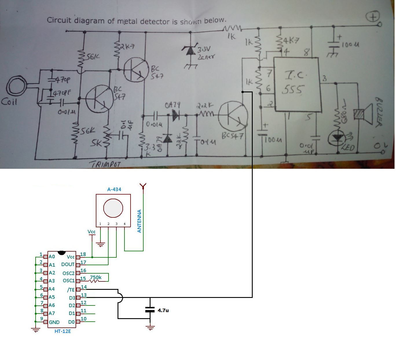

I AM working on a project called wireless metal detector
i have one pare of ht12e encoder and ht12d decoder and RF MODULES
when i am sending data from RF transmitter it properly sends the data to reciever...but
i want that when metal detector detects the metal one one signal shuld be send through RF transmitter so that other reciever side i recieved that signal and do something for indication like led glow...i have attached the metal detector circuit diagram i am using.....i have checked that when it detects metal 555ic pin 3 goes high and low high and low.....i tried to connect that pin with encoder but from there i am not getting any signal to reciever....how to do that help me plss..i am noob in electronics.....
One best way is to remove the 555 ic and all its relevant components from your circuit, because you don't need that anymore since you are using a transmitter module. Connect the collector pin of 3rd BC547 (currently with pin 3 of 555) with your encoder pin. Keep TE enabled. See if it works...
That 555 timer is fixed with metal detector if removed that one how that circuit will work????
That timer ic is used just to trigger the buzzer. It doesn't have any role in 'detecting' metal'. I guess you don't need any buzzing sound or LED in the metal detector. You may need that on the receiver end!!!
When you detect any metal with the detector, the 3rd BC547 stops shunting pin 4 of timer to ground, thus disabling the reset. (I mistakenly wrote pin 3 in my previous post). A timer calculator says the 555 is configured for around 4.8Hz. You no need to feed that signal to encoder. You will get your signal directly from the 3rd BC547.
As you said "555 timer is fixed with metal detector", I guess you cannot modify it?? Just for testing, take a connection from pin 4, add any electrolytic cap with it w.r.t ground, and feed that connection to your encoder (any of D0 to D3) for transmission.

(add any electrolytic cap with it w.r.t ground,)
I didnt understand this one what does this mean????
I am talking about this... That capacitor isn't compulsory, but just to filter any oscillations if exist. Give it a try and see if it works...

no not working

It will work same, the fact is the circuit you showed will act as a NOT gate. It will just invert the signal. You will find your 'output' as logic high all the time, except when it detects a metal.
Resistor values are ofcourse not critical, but 10k will be little high. Use 4.7k at most. Have you tried this circuit???
Referring to the setup I showed in my post, I want you to check the voltage level at pin 4, with metal & without metal near the coil. Compare the voltage level with buzzer sound....
