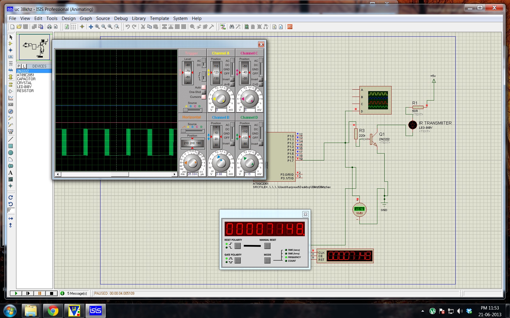

this is my circuit:
NOW CAN YOU HELP ME THE CODE IS SIMPLE I MAKING 38khz on for 1ms and off for 6ms just help me to achive the range..!
i have check the output is working fine..!
this is how i attached the sensor:
waveform using proteus software but i have also checked on oscilloscope its working fine:
what is with the pauses between the burst..? right nw my code continously producind burst like 38khz is on for 1ms sec and off for 6ms..?
