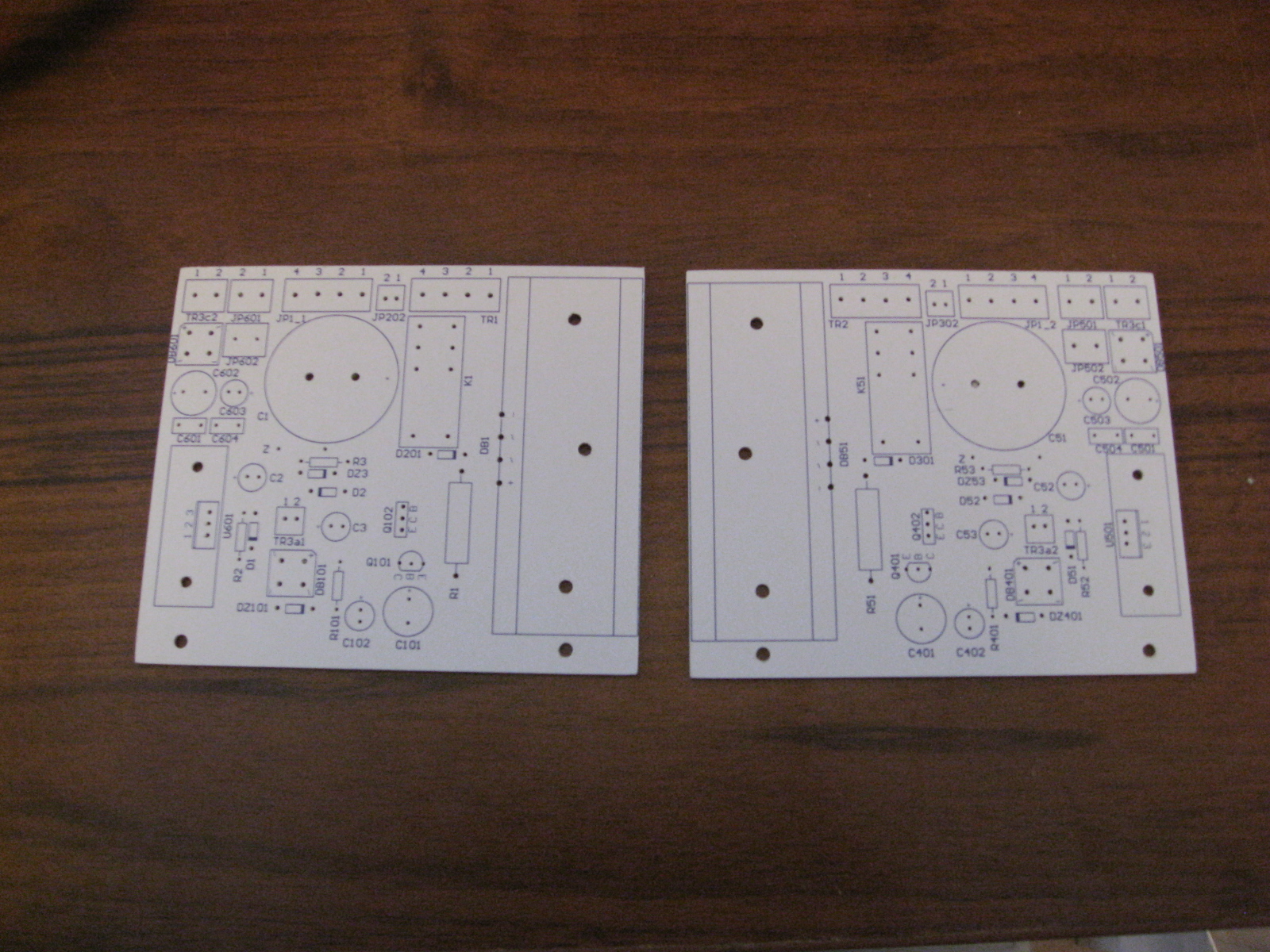

Construction
The first module “Z” is Greatz bridge, tension filtration, generation of negative tension to fund the operational amplifiers, 34VDC positive power fund for other operational amplifiers, fund from another auxiliary transformer for a relay to switch the main transformer steered form another board and a 5V 1A power supply to fund the measures.
Both “Z” modules boards for power supplies are symmetrical to fit the housing. This helps to easily mount ARK connectors and the heat sink for the rectifier bridge.

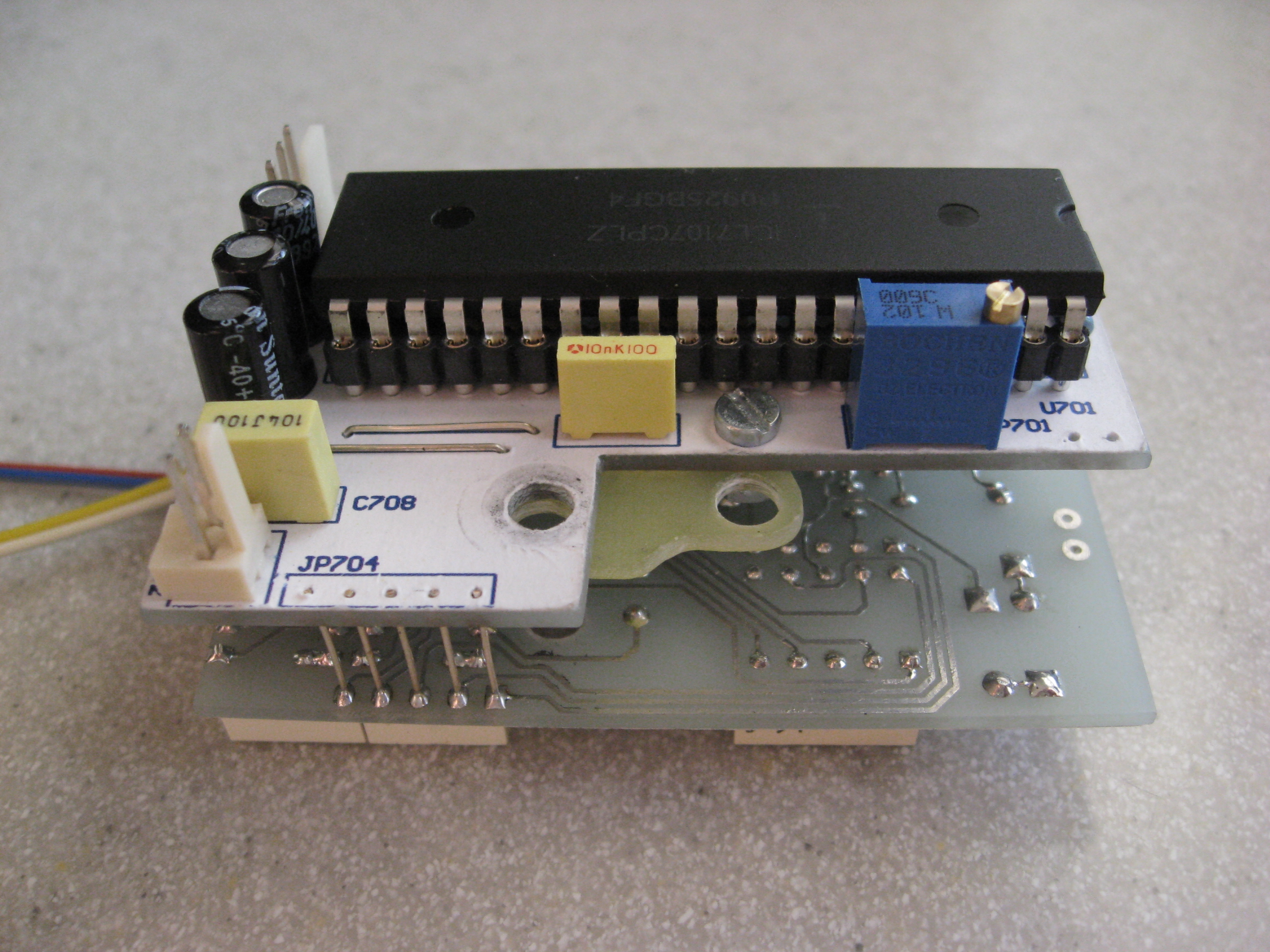

Measurement of voltage and load current is based on the ICL7107 dice. The measures' plates are bilateral and designed so that for each adapter on one plate is a voltmeter and ammeter. Also, there are measures of the radiators' temperature. It was done by using the ICL7107 dice and LM35 as a sensor.
The visualization of power parameters is viewed on seven segments displays, because they are easier to read than standard LCD display.

  • making the module with the rectifier bridge, filtering and relay, connection to the transformer and activation of the relay from an independent source to verify the output voltage.

Measures control is to align the reference voltage between 35 and 36 pins of ICL dice. The measures of voltage and current applied use external reference source in order to become independent of heating up the meters and the error resulting from this. In the case of temperature gauges, such accuracy is not needed. The display of the decimal place is an overstatement, but it's no need to abandon it. Powering of the temperature display is made by one rectifying diode (there are three of them in the diagram). It stems from the pcb design and so it remained. There are two jumpers on the plate.

Plates were made by photochemical method (Positiv20). Descriptions of elements on plates are made on stickers.
