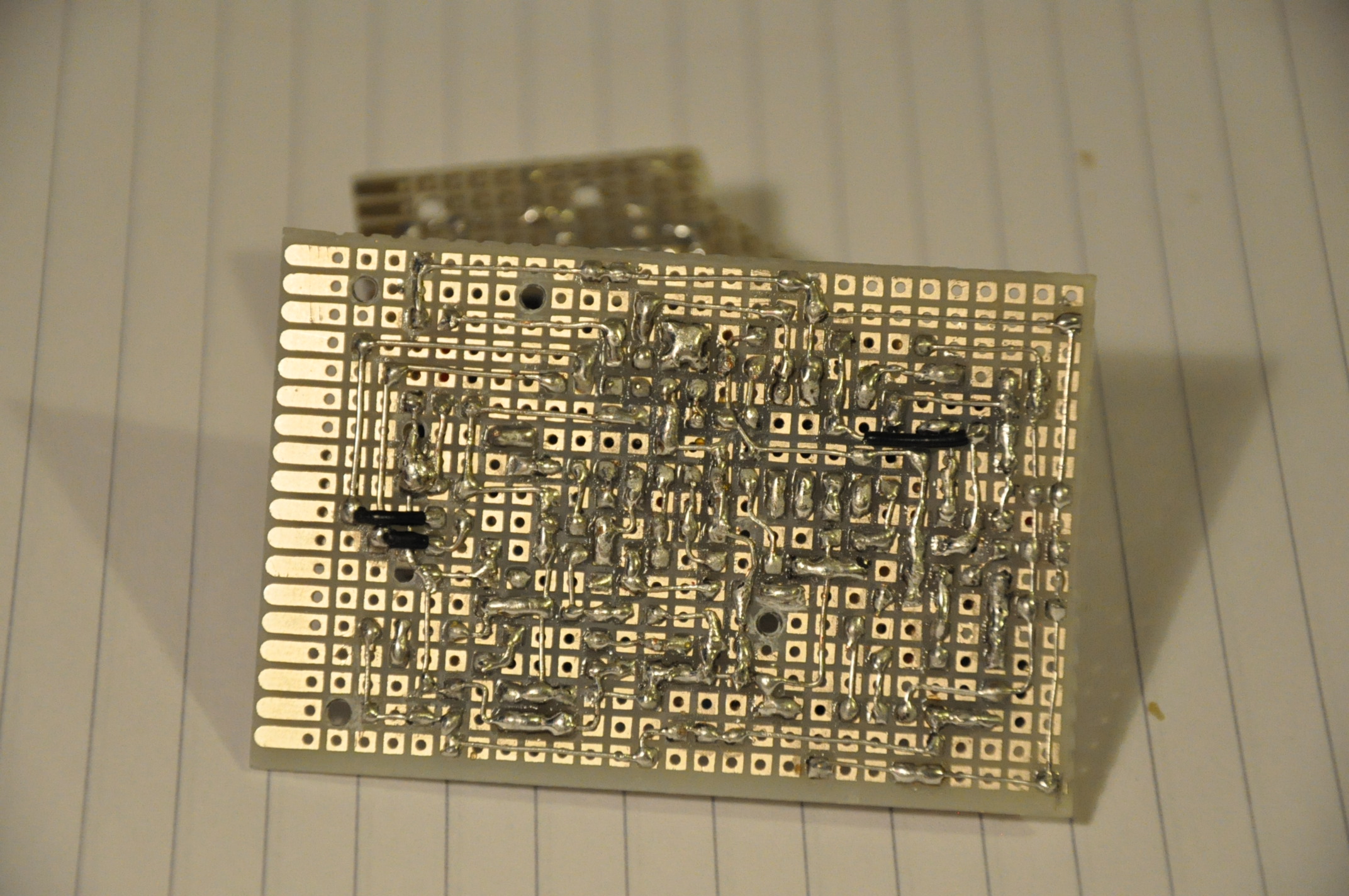

It could be easier if you can post photos of the hardware which you had done.

Here are my home made clone. It looks like bit of messy but seems fine anyway.
So can you see what the problem is?
The assembling is done on general PCB's and thus May have some errors. Re- check every line with multimeter in continuity mode. Which version of the Pickit2 programming software you are using? What error is displayed while you pluging the programmer?

Thank you. I have found the problems and solved all of them. Now it is successfully connected and I tested to burn some program with 16F84A and it worked well.
To make sure it, I have Vdd Pickit2 is between 3.8~4.2v and Vpp is 11.9v, is it OK?
Anyway, I now feel like having a very powerful device..
Thank you again.
The Vdd to the target should be more than what you have said. Usually it will be 4.5+. Use 1N5819 diode which connects the USB + to the ICSP + (Vdd pin). getting 11.9 Vpp is ok. Cheers and good luck.
