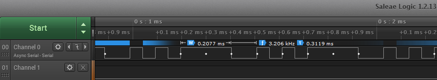

    user19
Hi Susan,
I tried the following settings.
Changed _CONFIG2( FNOSC_PRIPLL) to _CONFIG2( FNOSC_FRCPLL)
Added CLKDIVbits.RCDIV =0
Tried with the POSCMOD values with XT and NONE.
But we are getting the following screenshot .
Please find the attached screenshot. https://obrazki.elektroda.pl/4830664900_1492061552.png
Thanks

You need to understand the questions you ask in the first place! In post #5 you asked how to set up the oscillator to use the FRC with the PLL and that is what I showed you how to do. The end result of that is that the oscillator will be running at 32MHz. That also means that Fosc will be 32MHz.
However you have still set the FCY preprocessor symbol to the equivalent of 8MHz - that means your baud rate calculations will be out by a factor of 4.
You can't guess values for the CONFIG settings as you seem to have done with the POSCMD setting. You said you want to use the FRC and that means there is only ONE setting of POSCMD and that is POSCMOD_NONE. I even suggested that you leave that setting out of the _CONFIG2 macro and it would be what you want.
I have no idea what you are showing with the picture to link to in post #7 as I can't see where the character being sent starts. I can only guess that you are still sending the 'a' character which is 0x61 and I can't relate the bit pattern to that value.
However I see that you are STILL enabling the Rx interrupt which will cause your processor to reset if you have not provided an Rx ISR.
