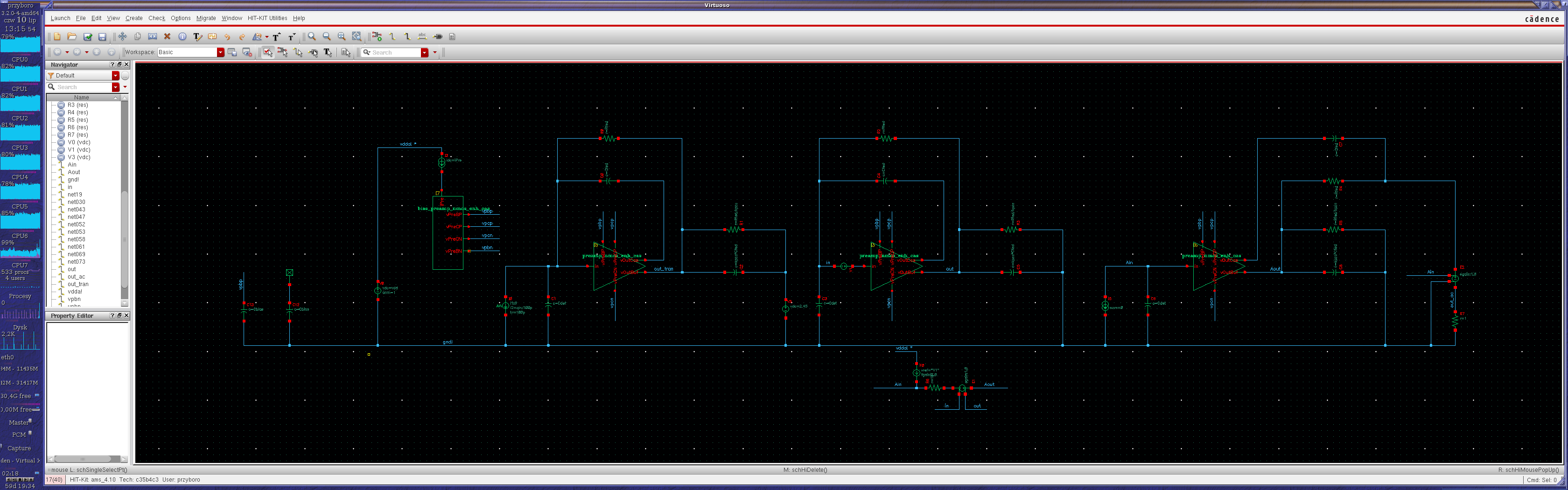

Some of the peoples simulating stability of transimpedance amplifiers using following schematics:
The feedback signall is out_ac node, it is a voltage drop on a one Ohm resistor R7.
Dominik, your crcuit diagram is hard to read. Please, can you describe the method with words (if it differs from the established methods)?
This is circuit diagram is for classic breaking loop analysis and I think it's described in Hurst paper about breaking the loop for different feedback types (that one from IEEE Tran. on Cir. and Systems I from 1991). But I have to admit that I'm only copy-paste it from one old wise guy, whose learn it from other, older and wiser one many years ago ;-)
In fact to ac analysis only the two right amplifiers are used, the V1 vdc source only sensing input leakage current for F0 cccs (it's necessary for transimpedance amplifiers due to quite large area of input transistor). E1 vcvs provides correct OP for replica amp with broken loop and the feedback current is sensing on 1Ohm R7 resistor.
