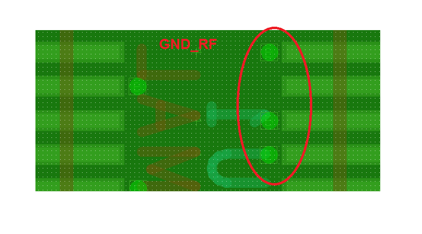

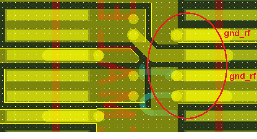

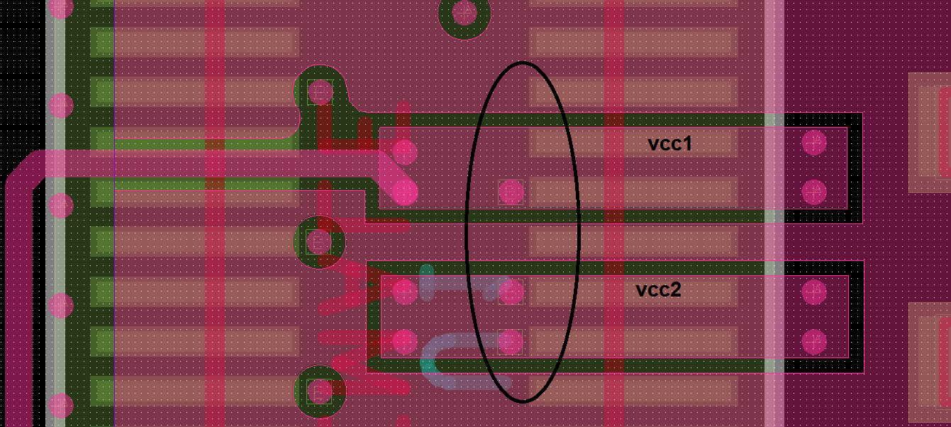

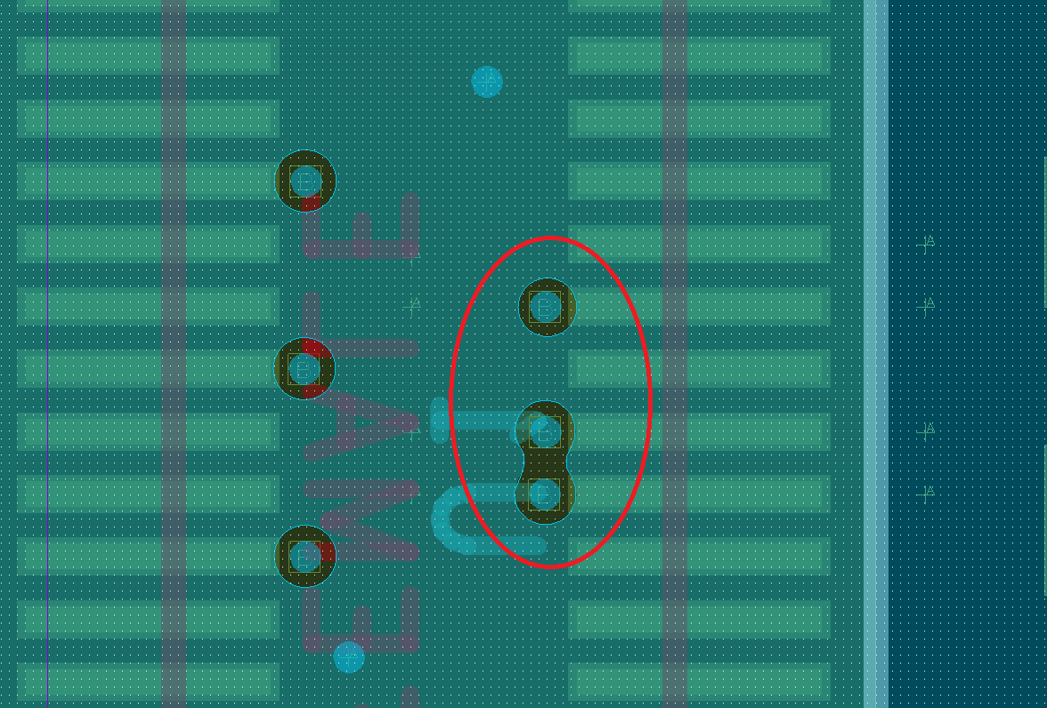

Hi everyone,
I am using Cadence PCB Editor 16.3 to develop a board (4 layers).
I have 3 vias connected to the GND_RF net.
The Top Layer and Inner2 Layer have a plane connected to GND_RF.
The Inner 3 Layer has a solid fill shape connected to the VCC Nets (VCC1 and VCC2).
The bottom has same nets connected to the GND_RF net.
The problem produced by PCB Editor is descripted by this points:
1. The vias are connected to the plane in the top layer (correct), to the net in the bottom layer (correct) but are isolated respect at the plane on inner 2 layer (error becouse the plane and the vias are connected at the same net: GND_RF).
2. In the Inner 3 layer, the Vias are inside at the solid fill plane of the VCC nets but any drc errors are shown by the PCB Editor.
I have 3 hypothesys:
1. the database of the board has an error;
2. the PCB Editor has a bug.
3. The design of the board has started on a Linux version of PCB Editor 16.3, than I have revisioned this board with a Windows version of PCB Editor 16.3. Is it possible that the migration of the board file from Linux to Windows has generated this problems?
In the attached file you can see the 3 vias in the top, inner2, inner3 and bottom layers.
What is the problem/Bug?
Can anyone suggest me a solution at this bug?
