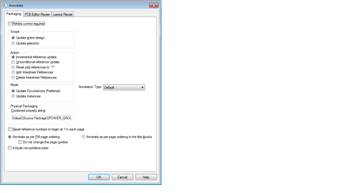

Did you for some reason copy and paste some components in the sub-blocks instead of instantiating them? If so you need to update all the components references. Go to the Window menu and select your .opj then select your .dsn . On the toolbar you should see a black U with a blue question mark like U? the tooltip says Annotate, click it.
Usually I leave everything as it is except the action, I use "Unconditional reference update". Click OK and it will ask you to change and save your design, say ok and then try creating the netlist again.

The problem is that you have in the two sub designs the same U parts. Thus eg. U1.1 is tied to two nets (the net in first and second sub design)
You can change the name of the part for each sub design in the property window of that part (if necessary).
Do it automatically as stated by Rookie is often the easiest way.
Also make sure you have correct mode set for project. If you using a complex hierarchical design you should have occurrence mode set instead of instance mode.
You can set this option from Tools>Annotate form
