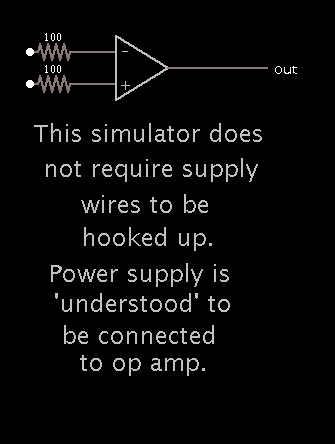

Things that might affect operation in one or the other simulator.
* Does the op amp need to have a visible power supply hooked up? Or is the power supply understood to be present?
* Are you required to specify a particular range of output? From 0V to positive supply rail? Or negative rail to positive rail?
* Are you required to specify an output impedance?

Example diagrams to show how one simulator creates an op amp and its specs.
A different simulator might have a different format. Or a different naming system.
These could be reasons why your op amp works in one simulator but not in the other.
