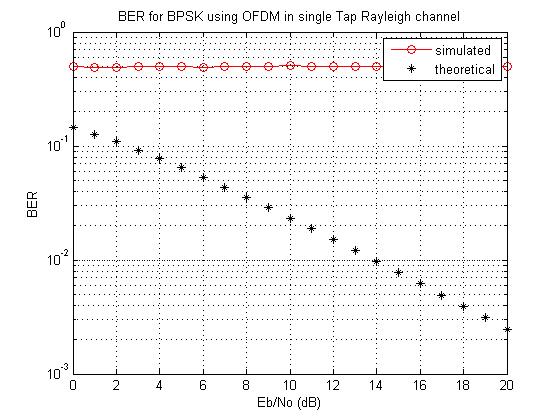

Hi
i have written code for OFDM using Single Tap Raylaigh Fading Channel. But the result seems incorrect.
Please help finding out the mistake.

It gives the following result.
